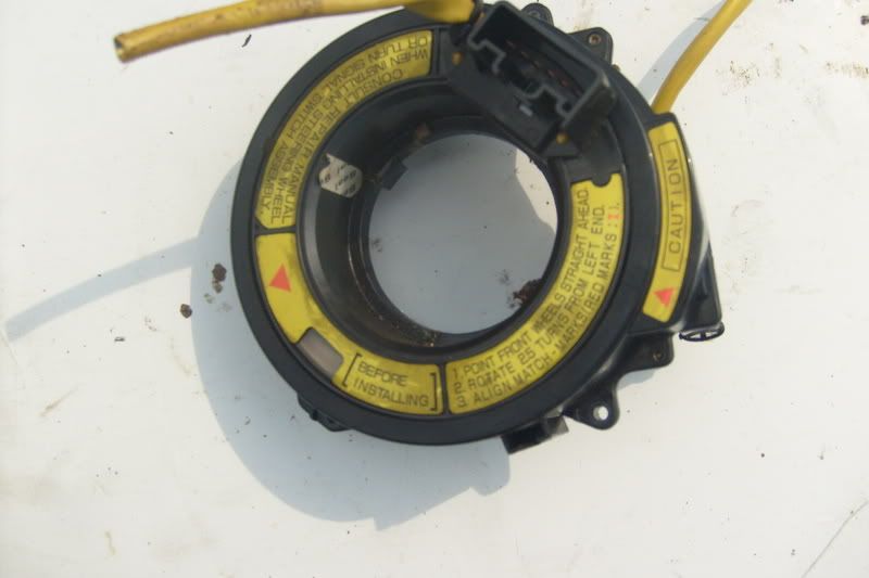

    The second one:
    The airbag, cruise control and horn (all functions on steering wheel) are all powered by whats called a 'clockspring'. Its located in/behind the steering wheel behind the airbag. Over time, they ware out, causing you to lose these functions.
    You need to source a good one and then get it fitted or do it your self. Labour can be expensive so if you are able, do it your self.
    Search the net or get a manual of how to disassemble the steering wheel.
    To save you some time, just go to the 'lextreme' forums, as all the info is there.
    Just remember to disconnect the battery. You dont want to set the airbag off cause 1, it may break your neck, and 2, you will have to take it to a dealer to get the ecu reset, = $$
    As I said, I had the identical problems, and this is how i fixed them.

    this is the clockspring

    hmmm, that doesn't sound right. When the clockspring 'fucks out', you will suddenly lose all 3 steering wheel functions, as they wont be getting any power. If they seperatly died over time, for example; no cruise control and airbag light on, but horn still works etc...
    it may be something else
    understand what i mean?
