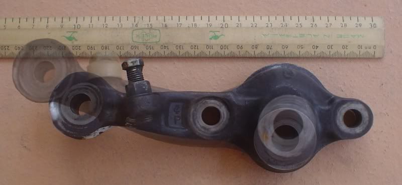

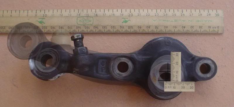

    It isn't the length of the RA6x/SA63 PS arms that may help you, it is the offset ball joint...
    See pics
    xZ1x/MA61 vs RA6x/SA63 PS.
    xZ1x/MA61 is the longer arm in the images.
    You can see that the RA6x/SA63 PS arms are offest ~10mm, and will also give a little bit of extra castor. Steering will also be quicker.
    The RA6x/SA63 PS arm ball joint hole needs to be reamed to fit xZ1x/MA61 balljoints as RA6x/SA63 balljoints are smaller than xZ1x/MA61.

    Wilbo, any way of doing bumpsteeer calcs without having to set them up on the car first only to find out it wont work? it should reduce the scrub radius and increase lock but it could have other nasty affects at the same time.
    the AE86 P/S steering arms have a similar offset to those above but i dont thik they will allow you to run thick RCA's with the R33 upgrade as the LCA and disc may hit.
