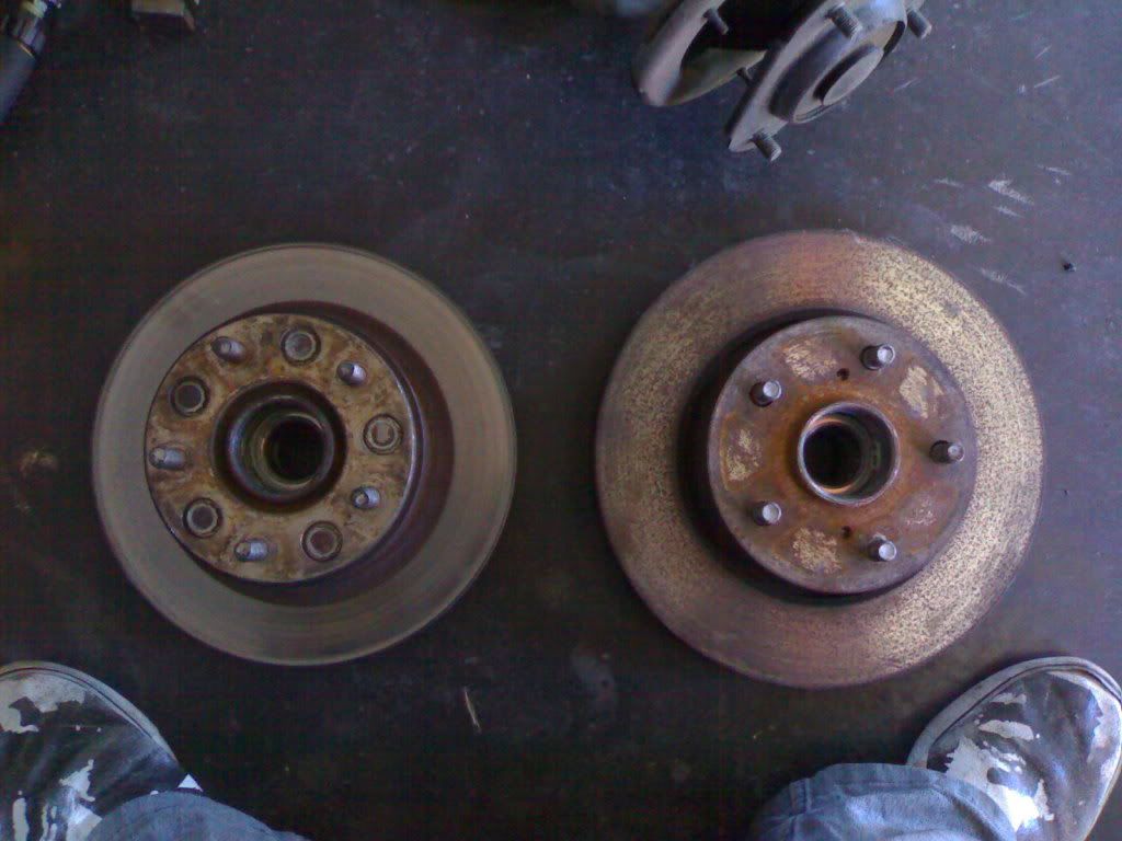

    Initially i thought the issue was with the Shit ass 8mm spacers that were installed
    on the coilovers in japan which were these :
    (left of pic)
    So they were removed, and to do so i had to remove my whole rotor etc etc
    as the original studs on the hub/rotor were chopped
    and once spacer was removed they would be unuseable.
    So i replaced everything with my std (50,000kms) GX81 rotors and 5mm slip on spacers i bought from malz
