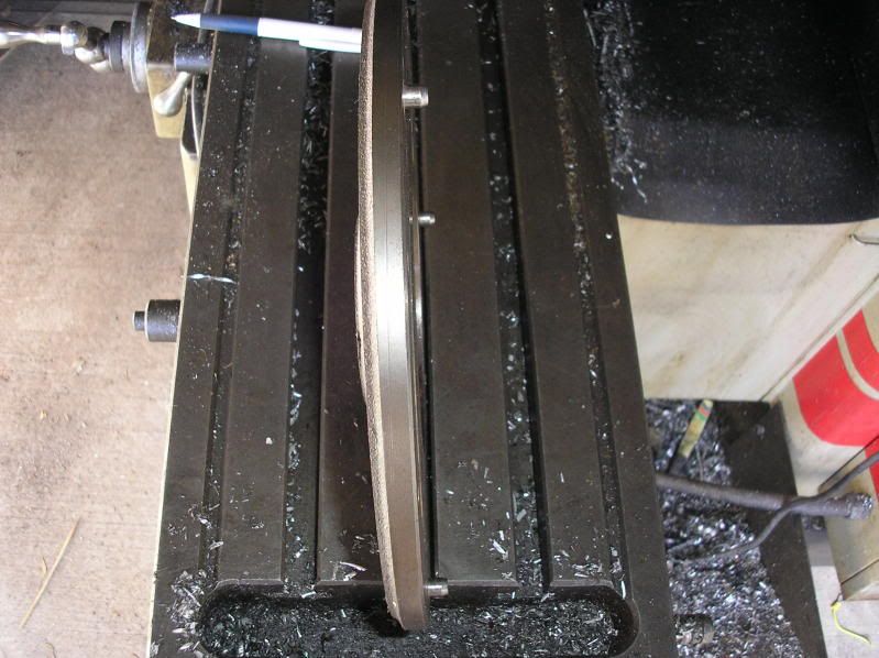

    Cool Re: No pistons, no fuel, no worries! Toyota Sera EV Conversion begins…
    Sunday, 26 April 2009
    Been a very productive weekend

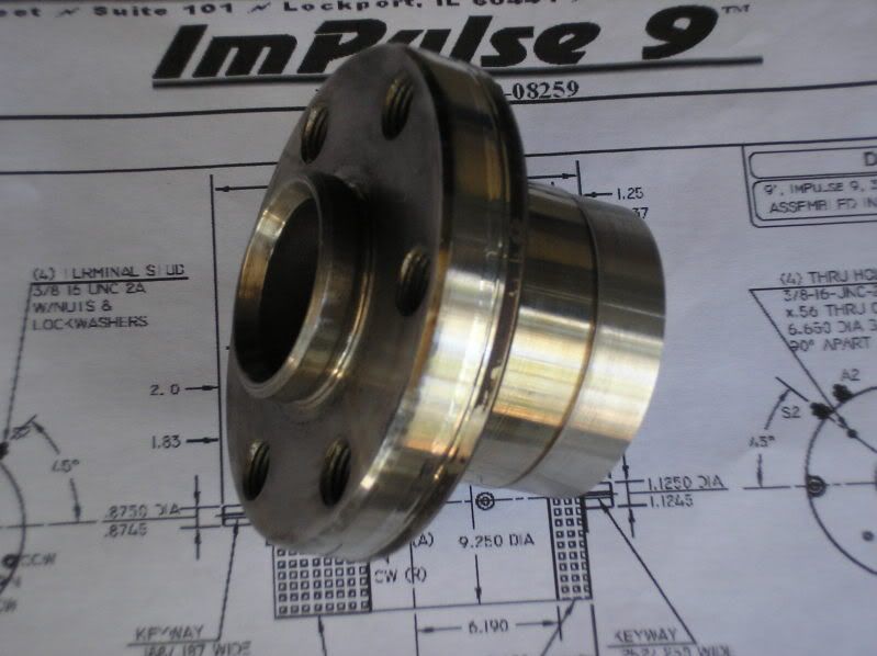

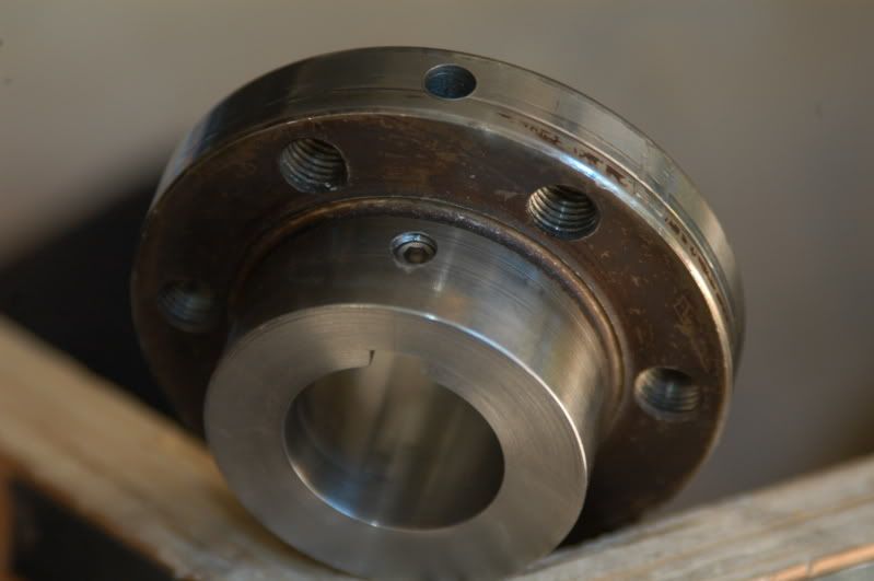

    Picked up newly bored & keyed crank end from the machine shop on Friday arvo.
    Had to do a little cleanup as there was a 5 thou variance from one end to the other :/
    Keyed, tapped & ready to go…
    That aside it now fits like a charm..

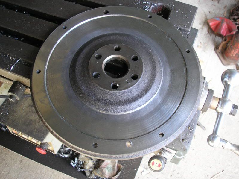

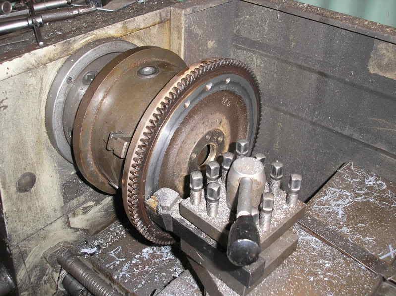

    Next up, flywheel goes on a crash diet.
    Before:
    After:
    Would have been nice to get before & after weights… oh well.

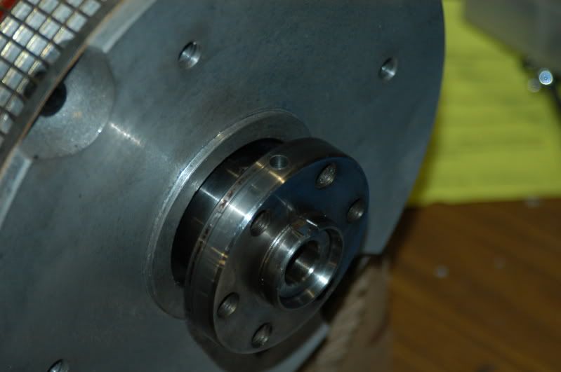

    Bolted everything up this evening.
    Looking good:
    Alignment is spot on!
    No trouble what-so-ever getting the gearbox / clutch lined up & was able to turn it without binding
    Planning to test fit everything tomorrow morning & work out how to go about brackets for the air con pump etc…
    Need to get some new engine mounts as some of the original ones are starting to crack up.
    Have also started work on the battery box, planning to ditch the back seats & fit in 3 rows of cells in a tapered shape to suite the chassis contours.
    The box will be made out of 3mm steel sheet & incorporate 2 large fans to pull air from top the through the battery bank & out the bottom where the passenger seat wells are (pending removal).
    I am planning to monitor the average temperature of the cells in several locations to determine fan speed & provide a visual indication / warning on the dash.
    Busy busy phew!
    Ok bring on the F1 already….
