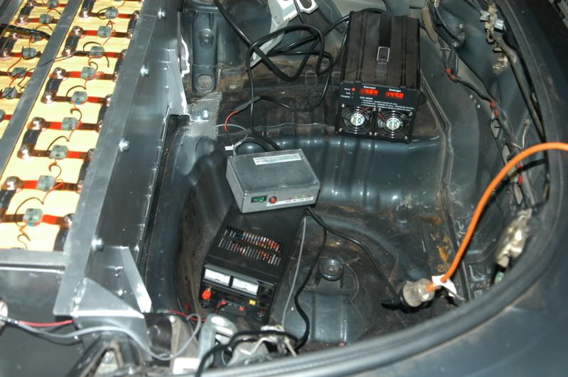

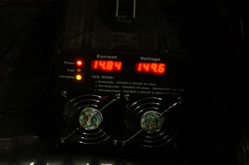

    Batteries on charge & nothing blew up whooo!!!
    Pulling near on 15A from the mains socket, extension cable gets a little warm, but all good
    Batteries don’t even break sweat, barely over ambient temp after 2 hours.
    Power!
    Temporary charge rig
    The bench power-supply is for activating the charge contactor, as a safety precaution no HV is present on any connectors until 12V is supplied to the system.

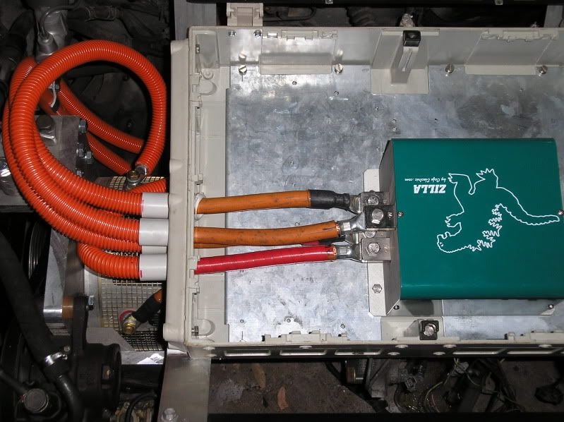

    Updates!
    Tuesday, 22 September 2009
    Had a productive weekend, routing the high voltage cables & installing the controller box.
    I scored the funky IP rated box from my local scrap metal dealer, including the 2 little ammeters, which I may rig-up for accessory current monitoring.

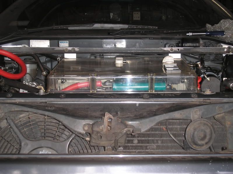

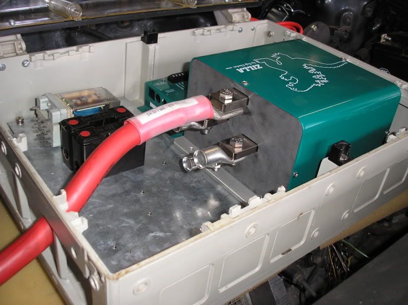

    Test fitment of zilla box & accs
    Bonnet clearance, No worries!
    Close up of Zilla business end & 0000 cable

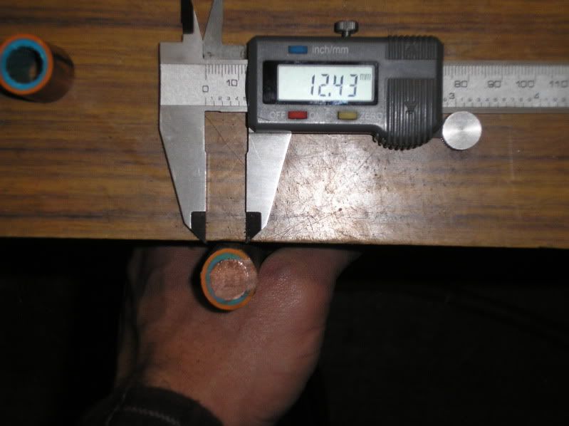

    I would have liked to use the quad 0 cable for connection between the Zilla and motor, but it was going to be just too tight, so I had to settle with 00 gauge instead…(oh nows teh voltage drops!!11)
    00 Cable, Its pretty big….
    I routed the cable through the ‘tranny tunnel’ conveniently there were plenty of captive nuts from the old exhaust heat shield mounts. It was just a matter of making up several clamps to suite.
    The most difficult part was getting the orange conduit to bend tight enough to fit.
    With a bit of perseverance & a heat gun we had a win!
    Cables are in!
    Getting close!!
