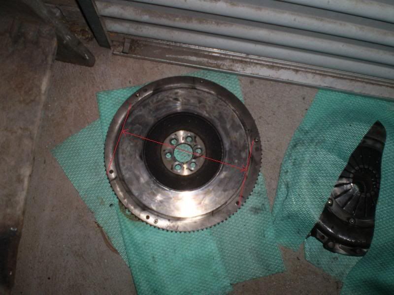

				Hey guys,
Just double checking this because i am about to buy a clutch and dont want to buy the wrong clutch for my generation of 1G.
Now i was told this is where i measure?...not that i dont trust adanbut just want to double check before i go ahead and order the clutch.
He said it will be 225mm accross there if its a gen II and 236mm if its a genIII
Mine came in much closer to 236mm so i assume is a gen III
The only reason i ask this question is because i always thought my car was gen II because of the ECU plugs
yes my car is running an auto ecu i found out? and its a factory manual?
Just making sure because i think ive heard before u can run a genIII flywheel and clutch setup on a gen II motor?
Is that correct?
Cheers guys.

You can run a Gen3 clutch/flywheel setup on either though, so long as you have all the matching bits.

Where adan has pictured to measure? is that the correct place to measure?

				While i cant see the pics, you will need to measure the shiny bit (pretty much the contact face of the flywheel) - that is what diameter people refer to.

But as JCMO said, if you have a matching flywheel and clutch, then it doesnt matter what generation it is.

				Ok cool so where adan is telling me to measure is correctthanks adan and paul
So it appears my flyhwheel is gen III...

But still i think mine is a gen III flywheel then.

				I think technically you could run a smaller clutch on the bigger flywheel anyway. It would just have the 11mm of unused material? Anyone done this?
