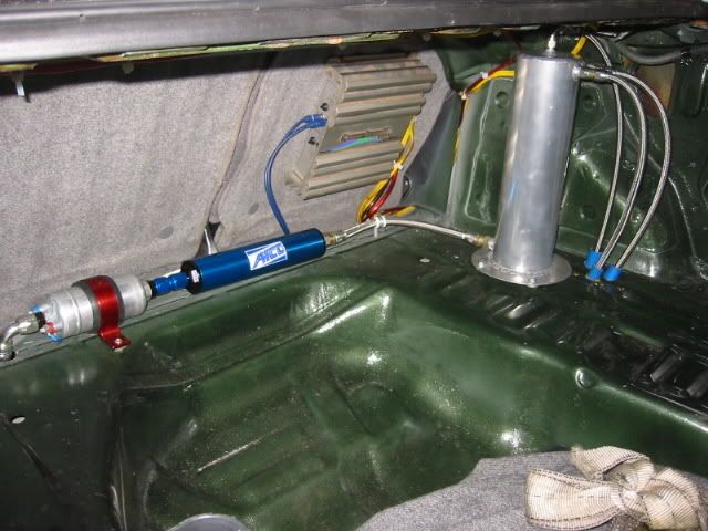

    mines 2L, and after a drag race 12sec at full noise, you can hear the std intank pump catching up filling the surge tank again, i run a bosch 044 external, thats with 550cc injectors which flow alot more (874cc at 77psi 100% - flow tested today), -6 returns into the surge tank, and excess from tank goes out top of surge tank into the main tank. run a -8 feed as well.

    Only if you return to the main tank would you empty the surge tank. If you return to the surge tank you will only deplete it by what the engine is using if the lift pump is not adding to its fullness.
