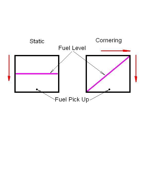

    Junior Member Backyard Mechanic benjamin's Avatar
    237
    Default Re: Why are aftermarket surge tanks so big?
    One other thing to think about is how often are you going to be running low on fuel in the tank, on the street you might get a little low in the main tank but you won't (or shouldn't) be driving hard enough to be starving the pick up for very long. And in a track situation you should definitely be keeping an eye on your fuel level anyway, probably keep it above half full at the very minimum. Having a massive surge tank would probably only be beneficial in an endurance type race where limited pitstops and getting the highest mileage per tank is of major concern.
    And what is the maximum (instantaneous) G forces you can pull in a turn or even acceleration? I honestly don't know what is a respectable effort but even if you make 1 lateral G with half a tank of fuel and the pick up is located at the centre of the tank, the pickup is still going to be submerged.
    I really believe that with a street driven car that is occassionally used at track days, a 1L surge tank would be perfectly fine.
    237
    Here's some fully hectic diagrams to show what I mean
    the red arrows are showing the G forces (which are all equal in this instance)
    engine isnt under full throttle under braking/cornering so the tank would be more likely to fill upto being full during this time. so by time you open the noise up exiting the corner its full of fuel.
    if the tank is completely dry you still have the surge tank full plus the fuel thats in the main/return lines, then as soon as the lift pump comes back into fuel it starts filling the surge tank again. add to that a lot of you guys are talking about EFI tanks which are baffled from factory hence less likely to have fuel surge in the first place.. 1L like the ones i sell should be heaps for most 4cyl appt
