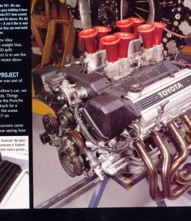

these look good
Would you believe that those were a prototype set that NEVER got finished by the guys who started them?
He sold them to a guy in NZ who ended up spending a couple of thousand $$ getting them to work perfectly and reliably.
Peewee
2013 86 GTS
Would that be A1 turbo is NZ?
I think those guys and Bullet are the only mobs still doing off the shelf ITBs?
I can't comment on the Bullet gear but the gear from A1 needs alot of err 'finishing' to function even half decently
Nah, its not the A1 gear. It was built by that company that did the Countach's, and then the Redback. The name alludes me at the moment, but that photo has been around the net since probably 2001. As you can see they bolt to the stock lower runners.
I lied. http://www.carbontech.com.au/ is the company.
Denzel uses an ITB setup from a guy called Mick, and those were the casts that either you or Ed were looking at buying a few months ago.
