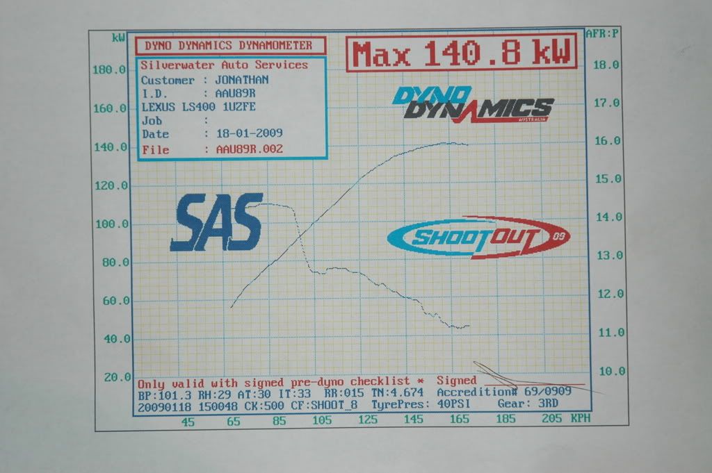

  9. #69
    752
    Default Re: Running Lean - stumped as to why
    This guy had a good point a few posts back...
    Quote Originally Posted by RONA
    Not mine
    Only goes under 12:1 in the last 500-1000rpm. 100% factory 1uzfe & ecu
