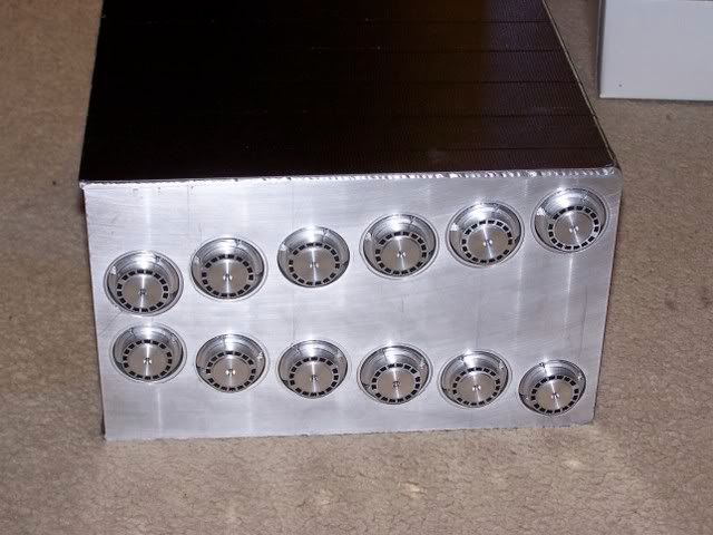

    Got the LS1 intercooler back today for the twin turbo project from been welded now for the custom end tanks. The feed is from the narrow end, with the two turbos feeding in one top and one bottom. The chilled air coming together in the center. This will feed from the rear to the front and into the throttle body. Unlike the current set up the feed is left to right. The water will flow left to right in our set up with possibly twin ice wells on each inner wing/fender. The super charger will be replaced.
    Lots of space to play with here.
    Looking good, 1800HP of cooling
    Darren @ TrickFab's
