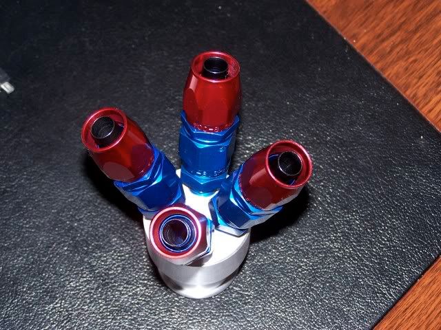

    Is the reason for the 4 water/coolant inlets to get a better flow through the core?
    Seems like a lot of plumbing fittings required at the inlet end if you have multiple tubes.
    web, why do you think cooling fans are necessary? I agree they are a good idea for the best performance, as the most heatsoak occurs at idle whilst stationary, but I don't recall many factory Water-Air intercooled cars from Japan having them? And they experience what is close to the worst conditions. ie low speed/high idling time in traffic, high temps (high 30C & low 40C), with high humidity in the middle of their summer.
    The single end caps suit any configuration of intercooler core layout even custom 4 core ones. They also give exactly the same amount of flow to each core in conjunction with our water splitters, so no hot spots or temperature differentials inside the intercooler as we control the water paths and flow exactly.
    Most other water to air intercoolers have issues here, it's no good just pumping water in one end and out the other. it will take the path of least resistance and in some designs not cool the whole intercooler efficiently.
    On the two custom 8 cores we have made, custom end tanks were designed to split the flow evenly, but these only suit one design and therefore are very expensive to cad and machine as limited or one off runs.
    The end caps are available in either dash 8 or hose-tail depending on your budget, dash 8 speed flow fittings can add hundreds of dollars, but if you want bling like everything it costs. The splitters are also available to suit both types of hose.
    The current 12 core we are working on will have custom end tanks and again these will be a one off. The good news is once we have made them, the drawings are done and CNC programs written, so if we were ever to build another the same costs would be reduced a little.
    The single end caps also take up less space at each end as the don't have the need for internal water passages to split the water reducing over all length. So they have some application advantages as well as been more cost effective.
