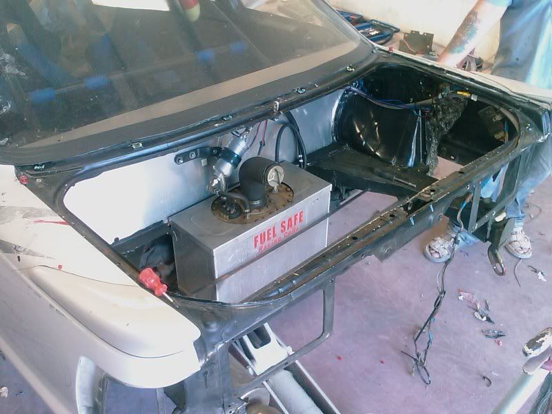

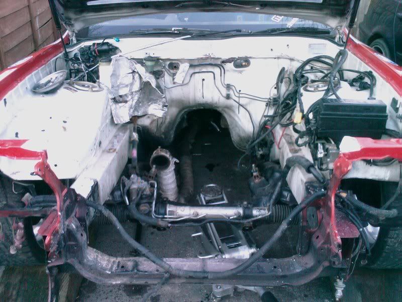

    Awesome work! Got any pics of the changes/work?
    Hows your weight distribution now?
    700kg front
    510kg rear
    Handles better than ever too!
    Cut away front bits
    Whats left of the back end!
    Sliding his D1 Soarer around the UK

    Hahaha, got some balls cutting that much out....but i thought you removed the subframes? Any pics of whats gone from underneath?
    58/42% weight split is a fair difference, pity these things are such a PITA to remove weight from the front.
    1210kg is a crazily awesome weight though. You are giving me some inspiration here.
