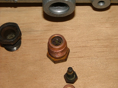

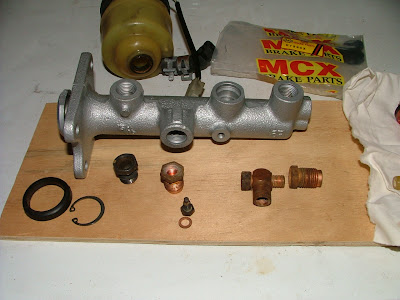

    fwiw: the 15/16 MC from my MZ10 has restrictors in both outlets - but these are nothing to do with proportioning braking effort - they simply slow down the return of fluid to the MC (preventing the pistons/pads from withdrawing too far away from the disk)
    This is the restrictor

    And this exploded view shows that there are two of them - one for each outlet.
    (clicky for bigger version of image)
    (note: the right-hand outlet on my MC has a banjo style connector)
