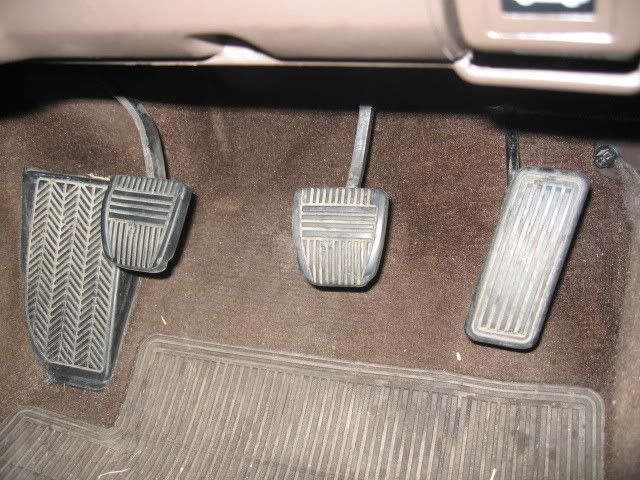

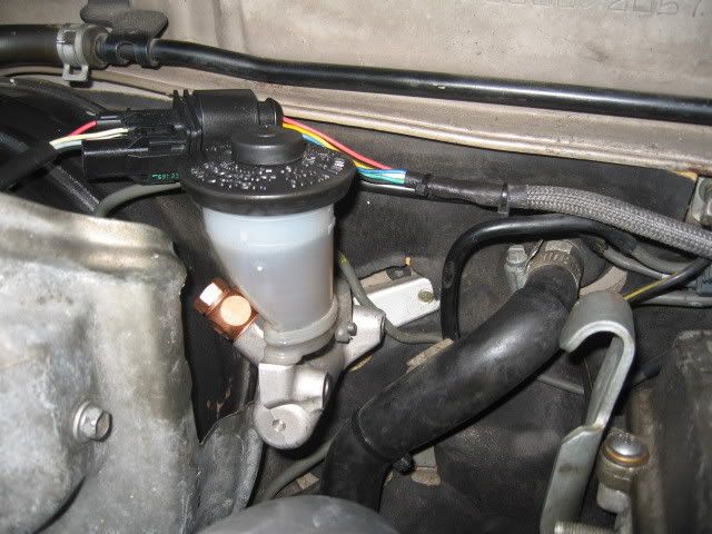

    I used MA70 peddels which I assume are the same and had no problems fitting it all up..
    Only things I had to do was drill the two holes threw the firewall for mounting and then cut a bit off the mounting plate so that it would sit flush against the firewall (as you mentioned the trans tunnel fowles with the backing plate a bit so if you cut the top left corner a bit it all sits flush).. No spacers or washers and it all bolted up fine.. The peddels also lined up pretty well..

    Default Re: MX83 Clutch Pedal Fookedness
    I fail to see how this can be called bolt up....
    Looks pretty much bolt up to me too
    Seriously not hard overall. Sweet pain in the arse that 99% of people reckoned it was "bolt up"

    Whats it out of? if its a70 does it use the factory firewall holes or do you need to add one as the angle looks wrong and it doesn't seem to line up with the top right (looking into the engine bay) hole.
    the JZX90 stuff bolts up to the firewall no problems and no pedal mods etc but the 1 bolt hole to the dash needs modding.

    A70, redrilled holes.
    Its all working now, but this was because ive had a bunch of people PM me and say "oh, i hear the A70 unit bolts up to the cressy".
    Works, yes, works well, yes. Bolt up, my arse.
