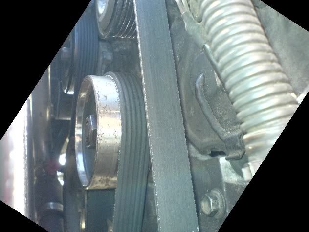

    This is what I did to mine . I had an aftermarket alloy VN commodore idler to which I had fitted a sleeve for another project. Bolted it to the housing with a 5/8UNF bolt and a couple of nuts and washers. I later trimmed back the head of the bolt to make sure I had clearance. Used a 6PK2225 belt
    You could probably use the idler without putting on the outer sleeve. I just used it as that was what I had.

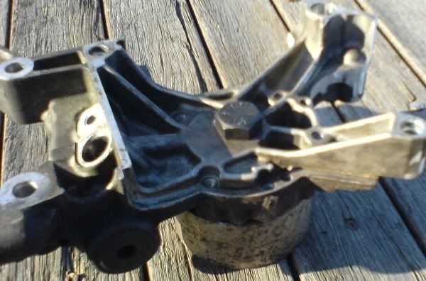

    Cheers I've just removed the guts out of the hydraulic pump & made up a plate to cover housing.... Just got to get a shorter accessories belt now......
