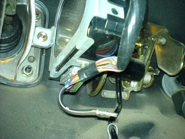

    Here is mine between the brake and accelerator. As you can see I have disconnected the black and white wire to make it work. It will not turn off if you put it into neutral while on cruise control but how often do you do that?

    Awesome work guys. My S1 has a slightly different looking set-up to that, but disconnecting the bigger of the black wires with white trace sorted me out and has crusie working again.
    Great writeup.

    I had totally forgotten about giving this a try, just went out to the car, cut the big black wire with the white trace going to the cruise ecu. Took it for a drive and WOW the cruise is working once again! (has been 2 years) What a simply fix, and just think I had people a couple of years ago saying yeah we can do it just bring the car around and give me $50 and I will fix it for you..
    Thanks again for the photos and diagrams..

    If you cut it, consider heat shrinking the ends of the wire you cut (i heat shrunk the connection). I'm not sure what would happen if the black wire did contact something, but I figure for 10c worth of heat shrink it's better to be safe than sorry.

    Big props to who ever figured out that removing the black/white wire in the cruise computer works.
    Just did it on my manual converted MA70 and it worked a treat.

    Just cutting the wire does work but its not the propper way of doing it , The wire is there to cut the cruise out if the T bar is moved to N or P while driving . I still havent wired mine properly but id guess the cut black white wire from the cruise ecu must now go to the cars new engine NSW.

    I may reroute that wire through the clutch switch then.

    Yep that will work fine .
    I remember years ago i had cruise in a manual without a clutch switch , if id change gears fast it was ok but if i were slow the engine ended up redlining
