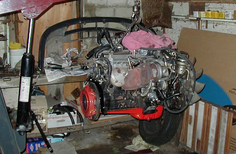

    The oil pump is in, the juicy red sump is on, a 5 puck Exedy brass button clutch with a 1200lb custom pressure plate has replaced the HD unit i had on before and the gearbox is on the back of the engine! Its like almost done I just have to torque up some bolts on the engine, put on my line for the oil pressure guage and she's done.
    Oil pump in the engine. If you look closely enough you can see just to the right of the pump on the crank it has 6M stamped on it.
    Just test fitting the clutch disc.
    The engine with the sump and clutch.

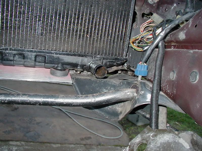

    I've also been doing some more work on the MA70 radiator.
    Here, i was test fitting the radiator and support bracket in the chassis. There's a 2mm gap between the inlet pipe there and the suspension bracket. That gap should increase though once i've drilled the mounting holes in the support bracket and bolt it onto the chassis.

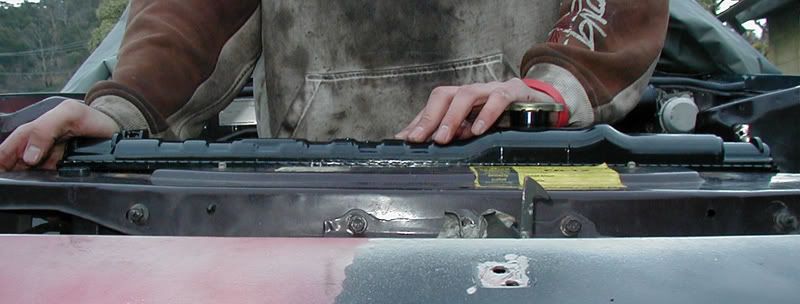

    And just checking how far the radiator edges above the top of the chassis. Should be good enough for the top radiator brackets to go on.

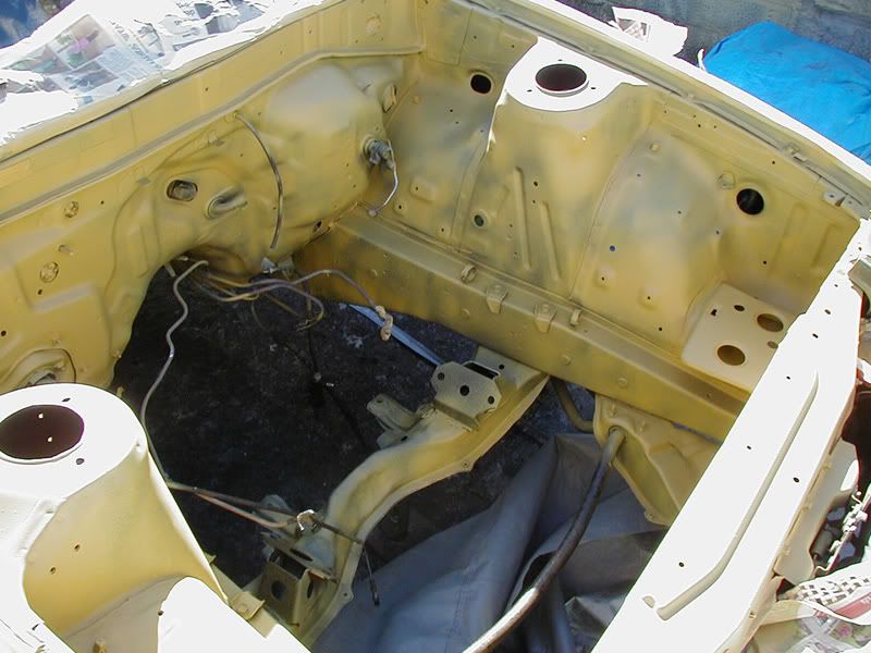

    All to go now is respraying the engine bay. Started sanding her down. Getting there, just slowly.

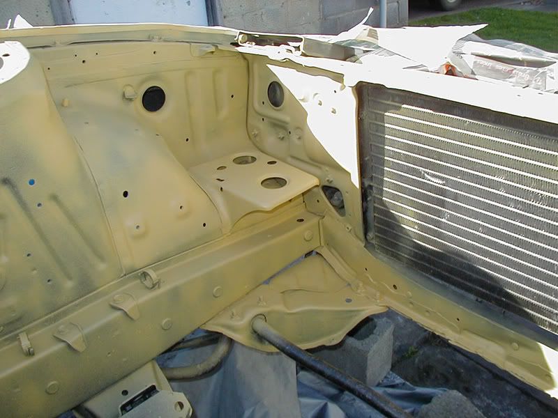

    Okay, bit of progress just quickly here, then i have to shoot off to work tonight.
    I finished sanding her down and have primed the engine bay! Took forever to do, not becuase it was hard, just becuase i hardly ever had time to do it in. But here she is all primed and ready for some paint lovin'. I'll be painting her tommorow Can't wait. The aim is to get the engine in by Sept the 2nd. Here's some pics

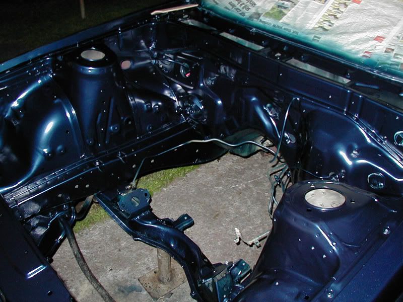

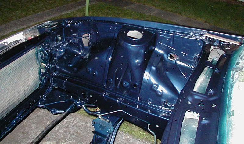

    Did i say last saturday? I meant today saturday It rained the previous saturday so i had to wait untill this saturday to get the painting done. Twas a beautiful day to do some painting aswell, blue skies, heaps sunny, birds tweeting?... You get the picture.
    Unfortunalty for me my boss chucked a hissy fit and made me work. Not happy Jan. But my dad was nice enough to do the painting for me while i was at work. So i helped him get all the gear setup before work. I watched him spray a couple strokes and then i had to rush off to work.
    I got a msg from dad later in the day saying it was done and it was looking brilliant! I was stoked! So happy its finally got done, it only took a bit over a month to paint... Needless to say the rest of my shift went VERY slow. I just wanted to go home and check out this paint job! Pity i finished after dark but i still managed to snap a few pictures of the freshly painted and oh so shiny engine bay! Big thanks to my dad of course
    The paint i used was Toyota 8L2, and boy does it have some pearls in it. Has so much in it, even the guy at the paint shop who mixed it commented on it. Looks fantastic though. I just dont want to scratch it putting the engine in now, lol. I'll have to bubble wrap it or something, hehe
