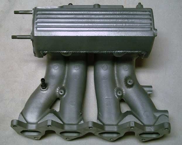

    This isn't exactly what the thread is about..... BUT, it does tend to solve a problem with using a smallport in a rwd configuration.......
    This first photo is a smallport intake in fwd configuration
    this photo (different perspective) shows a smallport in rwd configuration
    The typical way to do this is to cut the ends off the intake and reverse them. A bright guy here in Oregon (not me) gave it some thought and came up with a new way........
    He cuts the intake... but in a slightly different way...
    And then he swapped the whole thing
    Now there is some fill required, it isn't a PERFECT fit... BUT the plenum is basically intact(see rwd config photo above), and there is no butchering of vacuum passages, they are neatly incorporated into the chopped section.
    One more thing.............
    I always had a fear that the runners might be directed towards the end with the T/B... as the following photo shows, the runners are not shaped with an emphasis on either end of the plenum.

    nice idea
    all the vaccum stuff and cold start injector end up on the wrong side of the inlet manifold though

    Quote Originally Posted by Grega
    nice idea
    It isn't a big deal to move vacuum lines and even modify the EGR tube(if equipped). To move the 5th injector you add 10 cm of wiring and a bit of EFI hose and you are done... One of the advantages to doing it this way... is the linkage mounts and the throttle body are in their correct locations in relation to each other... Here are a few photos of it finished
