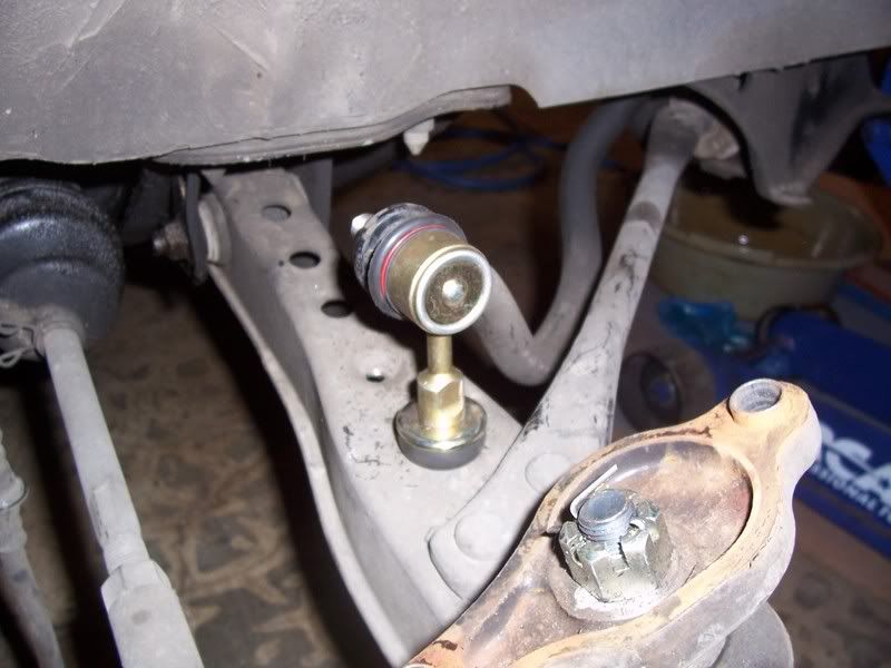

    I have Kei Office coilovers on my MX83
    There is nowhere on the struts for the swaybar, so I'll need to make a swaybar link to the LCA, or use some other method.

    What are those two weird ass clamps?
    Don't Trust Me I'm A Backyard Mechanic Jabtronic's Avatar
    Gold Coast, QLD
    405
    Default Re: coilovers into gx81/jzx81/mx83
    They're for the brake lines clips but they were bent/broken/unusable anyway

    Jabtronic - that is one of the pics i have and i thought it might have been the attempted swaybar mount (thats why i said it was really dodgy!)

    Quote Originally Posted by Jabtronic
    if you go to the LCA then make sure you buy a new swaybar that is about 3mm bigger than your current one as the load that the lca will put on it will be much higher than what the struts would.
    or if the bottom section is a steel sleeve (which i assume it is) then weld on new mounts to hold the swaybar on there (or cut the orig ones off a std strut and weld them to your KO coilovers) .
