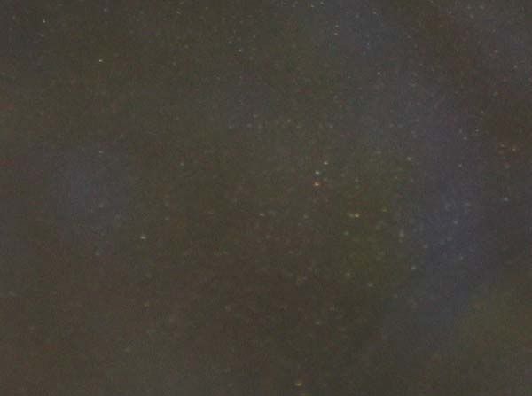

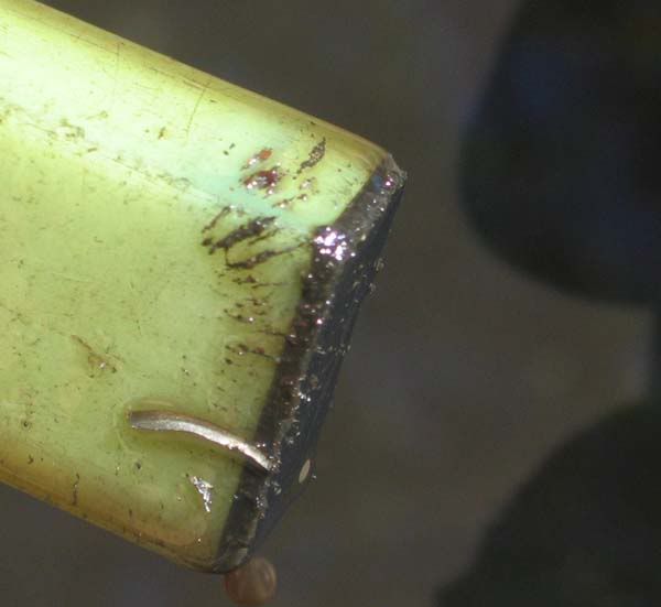

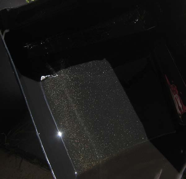

    35
    Default Re: Running in a motor. opinions?
    This is after 250km running in.
    Would you leave this in your engine for 1000km?!
    Suspended particles
    Some of the larger particles
    Bottom of the pan
    879
    Nice pics there.
    I'd have to say my oil didnt look as bad as that though
    Junior Member Backyard Mechanic sam-131's Avatar
    365
    wtf mate if i found a bit of steel that size i would be thinking hard about were it came off that carnt be good that oil looks like the oil i dumped out of a sized/rod out the side the block 304 i had had
    has it still got compression?
    it looks like it been making dry steel on steel contact did prime the engine befor starting it?
