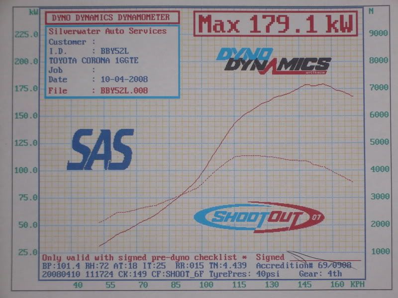

    My car had a successful run on the dyno today. Since the compression had changed due to the shaving of the head, the stock ecu cannot control the timing enough to cope with 15psi anymore. The timing was adjusted back to 8 deg base and boost was reduced to 13psi. Trade off is the same peak power but with less boost and most importantly, no pinging. An added bonus is more power down low as well. Overall im happy enough with the result.

    That's a nice looking curve.
    How long until it has some programmable management to take advantage of that higher compression ratio?
