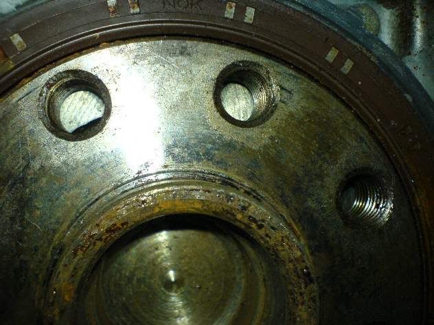

    I have new flywheel bolts supplied with the kit i bought hence me asking..
    It says to use 242 on the PP cover bolts. Is the 243 a locker also? Does it matter?

    The holes go through so a sealer would be good
