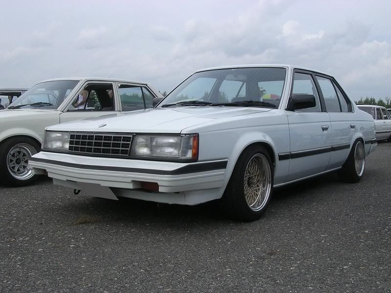

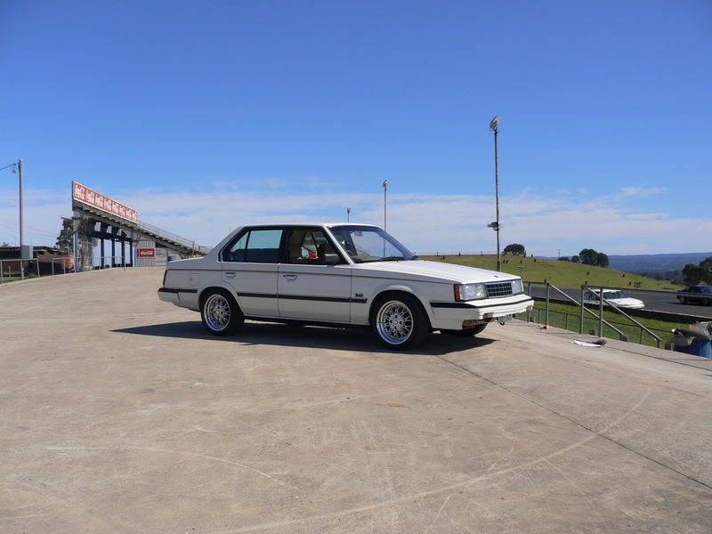

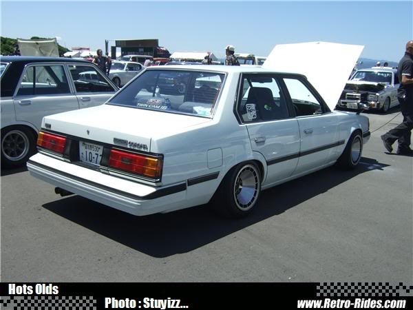

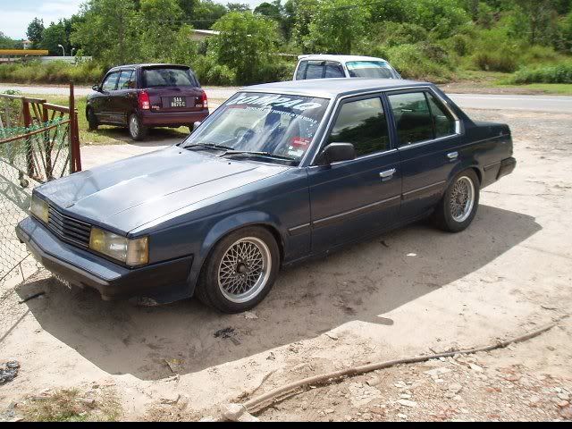

    thanks for info in advance and in apperication heres some pic's of sexy rona's

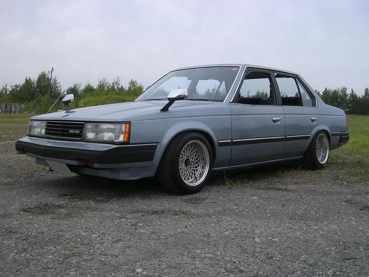

    similar...I think I will lost the pin stripe when I paint her

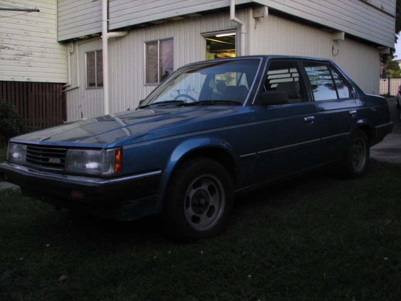

    finially, the reasion behind the thread... The rona Project... it has begun!
