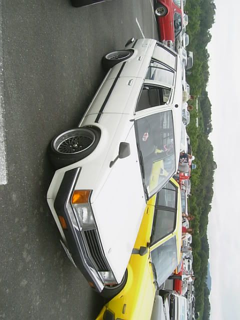

    would be cool to make soemthing nice and mint like this
    or this

    Nice pics you posted there. Gets me thinking.... I always wanted to get my hands on a wagon and turn it into a panel van.

    Fark man I love those rims on that rona wagon.
    I would love some dished rims for mine but they must be a special order thing because they always have the wrong offset.

    thats a sweet photo chop ill-minded, didnt notice it at first the camber makes it that little bit sweeter.
    you just got to search thru yahoo auctions japan, rims like thoes (assuming there SSR reverse mesh in a 16" maybe 8j ~8.5j i would think) you can get a set landed from around 1200 if your willing to wait a few weeks/month(s)
