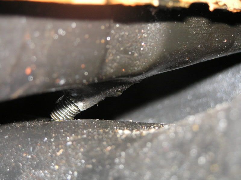

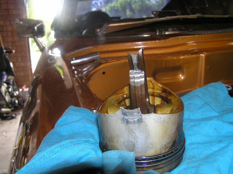

    Heres a few pics of 1G destruction
    Crank a gen 3 with spun bearings, lots of hairline cracks (gold28's old motor)
    Snapped rod
    Hole in piston, gen2
