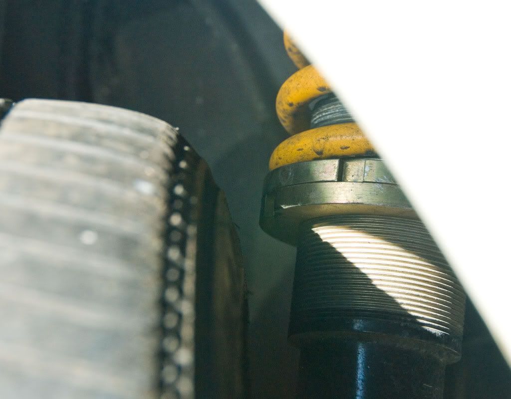

    Thanks for all the replys. Don't worry, I plan on decent tyres, and running some -ve like I am currently anyway.
    It's not so much the sleeve that is in the way - these coilovers have shorter threads than the 120mm kit I was originally going to use - but the position of the spring seat. (PS - you can get shorter sleeves crUZida, so no need to buy long ones then shorten). Unfortunately, if I went to shorter springs, I might run out of adjustment at the same ride height. Will have to do some calculations. Not sure that having the seats at the very top of the thread would quite clear the tyres anyway. The fact that these struts have been shortened (~60mm) only compounds the problem.
    These seats are wider than most, too - wider than they have to be. I could have the OD lathed down a little...
    I was going to take a photo from underneath when the car was jacked right up, but the battery was flat. To give you an idea though:

    Ok guys, I take back what I said about the collars not being the issue. Even if I had shorter springs, and the seats were above the tyres (i don't think there is enough room on collars to do this anyway), I still don't have much room.
    I think my only alternative is to run the +12s on the front, with the -8 brake upgrade... and find another pair of rims for the rear. This means yahoo japan and waiting months, or having mismatched rims.

    Here:
    Not taken quite straight on but u get the idea.

    Like I said, guard clearance the other way isn't an issue, it's only clearance from the strut that is causing me grief, and they're going to be rolled properly yes More neg will only make things worse.
    I just need to find another pair of 16x7.5 P1s in +12 and I'm sorted.
