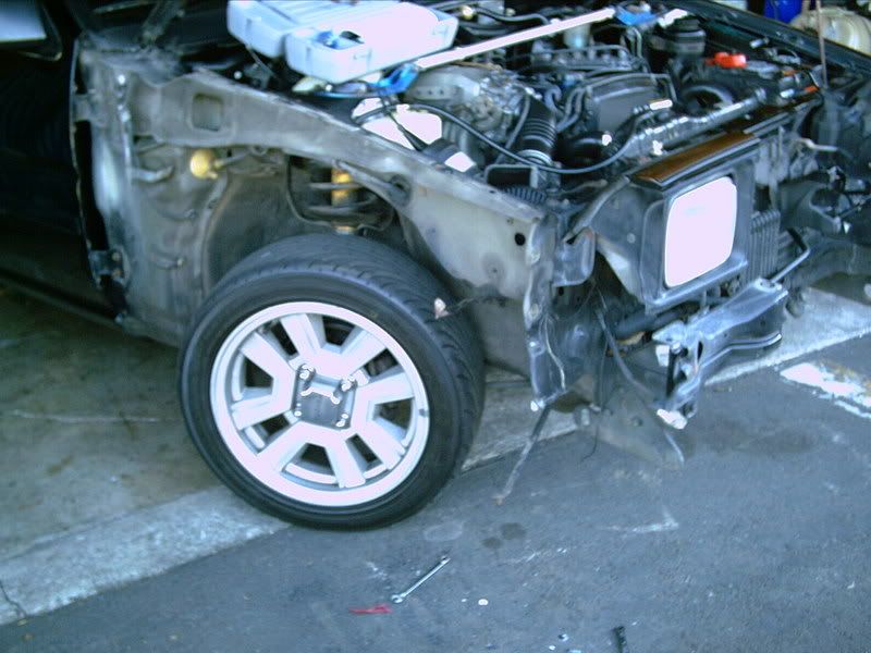

    I run: 87 AE86... 4AGE/112whp, custom springs(4.5 frt rate 3.0 rear ), Illuminas - I use a 205/50/15 Recent tires I've had are(current to oldest):Kumho SPT, Yokahama ES100, Kumho 712, Bridgestone RE71.
    All these tires are street... all are in the higher end (NOT the highest). I run 95% street with one or two track days a year(no drifting). I really enjoy carving up back mountain roads...... so tires ARE IMPORTANT.

    I use 15" Mark II Supra wheels -15x6 10 offset
