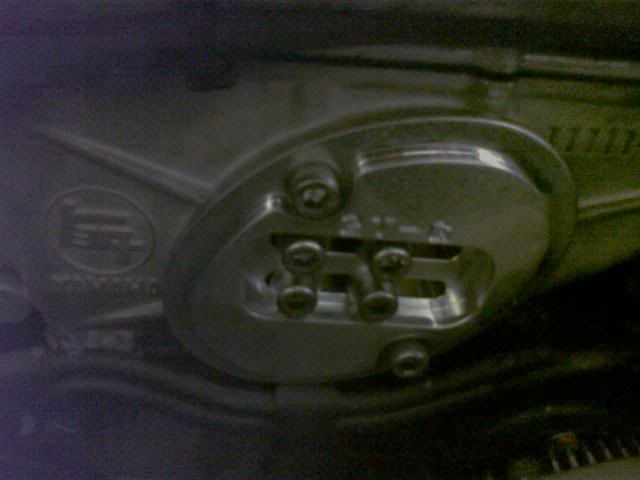

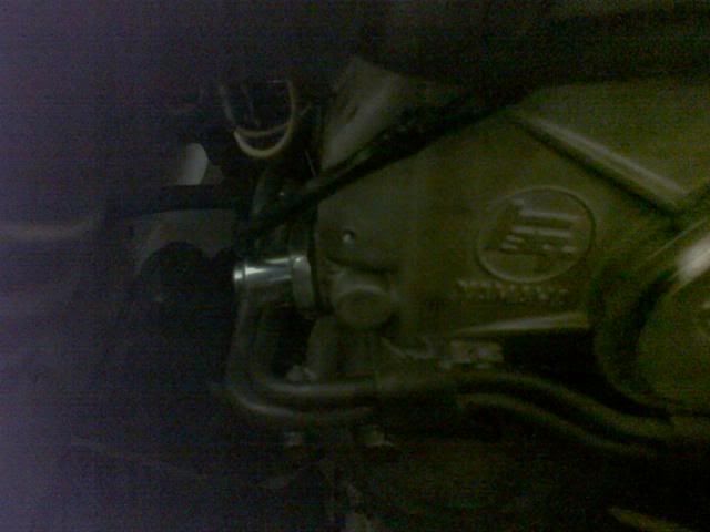

    my 3T-GTE timing component upgrades, only thing visible from the outside is the tensioner, but i have new sprockets and upper guide/sprocket aswell.
