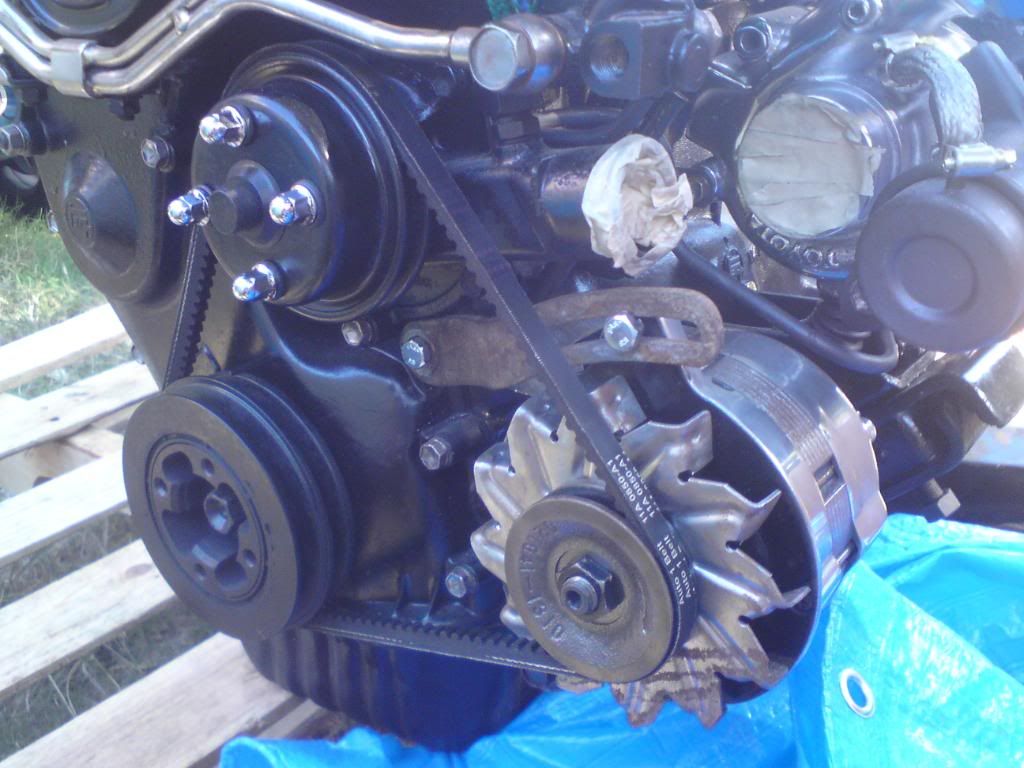

    Attatched is an image of my alternator im guessing they are the same??
    If you look carefully the letters are on the casting around the plug
    L - This goes to the warning light wire on your dash (this is the ground for the light)
    IG - This is 12v when the ignition is on
    S - This goes back to the positive terminal of the battery to sense the voltage its at
    B - (not in the pic) is the post on the alt with the thick charge wire to your batt

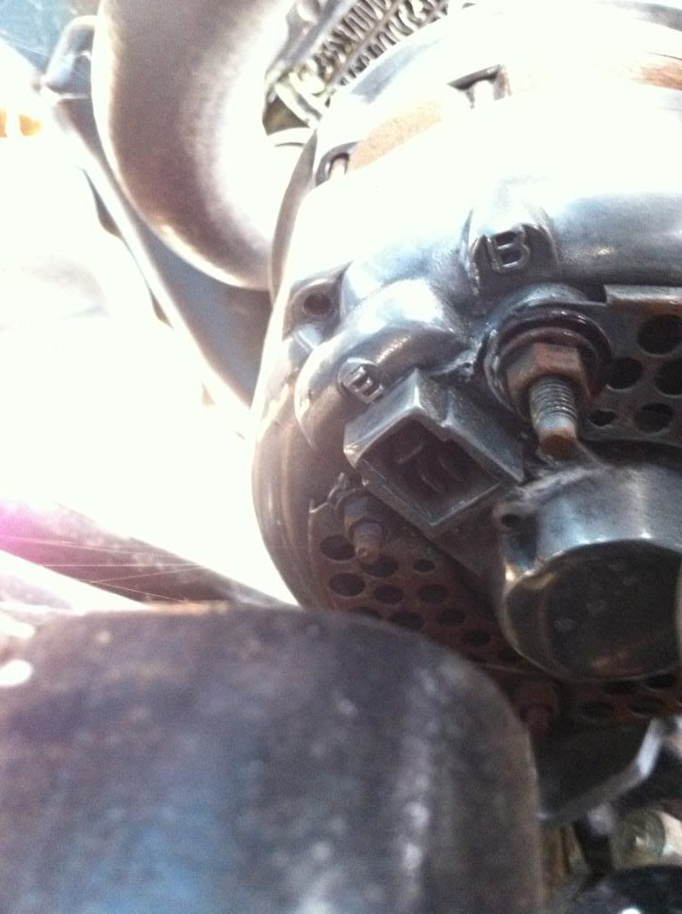

    Edit: here's a pic of the rear of the alternator on the '22:
    sorry they are so massive....
    Any ideas? EA Falcon maybe?
    Edit number 2: I used Google to search for the part number on the pulley. Turns out its a Denso item. I don't have the car at my house otherwise I'd go check the markings on it.
    I'm only asking so that we can wire it into the loom and drive this sucker!!

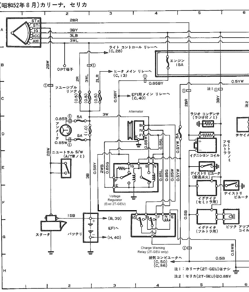

    looks like the pile of dead alternators on my garage floor. if its got E, N, F on that plug.. it requires an external voltage regulator. could be the original ta22 2t alt maybe? the T, K and R alternators were very similar. there should be a sticker on the side with alternator part number if it's not already polished off. the internal reg 2tgeu/3tgte are prone to failure. not sure if it because it sits under the thermostat and next to hot turbo.. but i seem to go through them. find a ta22 wiring diagram and compare, i think that should get ya going with the wiring side of things

    We actually worked it out today that it was an externally regulated Toyota item.. So a quick trip to the wreckers and we may have found a viable candidate for replacement. If we worked it out right, it should be a similar size to the EA Falcon alternators, so it will require a similar amount of modification. If all goes well I'll add it to the EA Falcon tech thread that is already on here!

    This isn't TA-22, but I believe the terminals are the same as what you pictured.

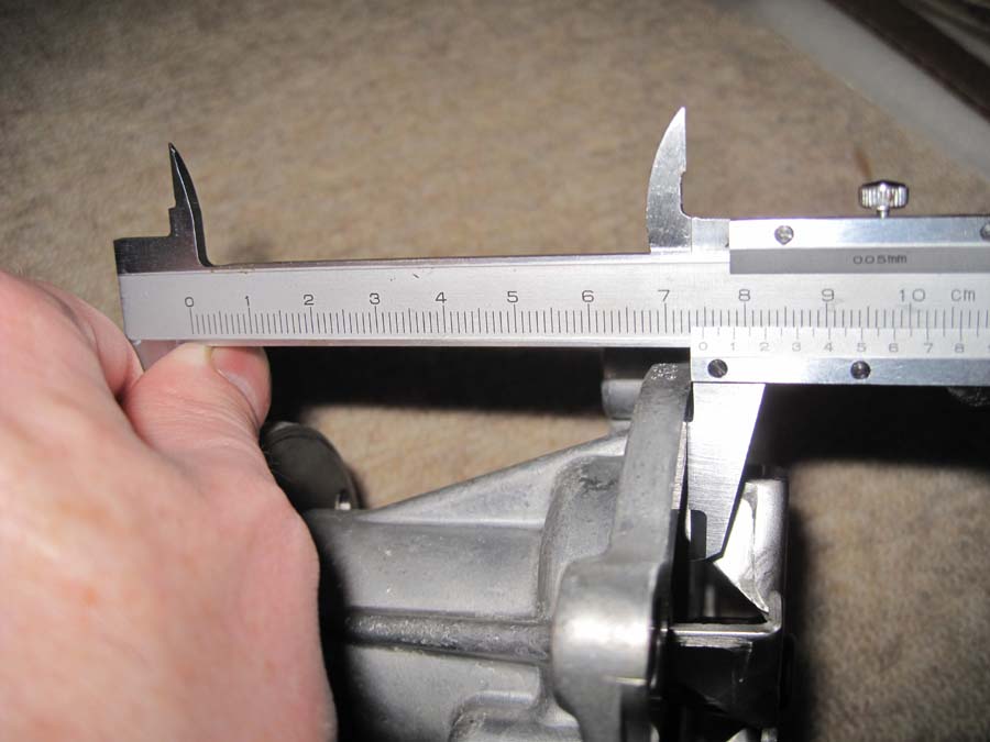

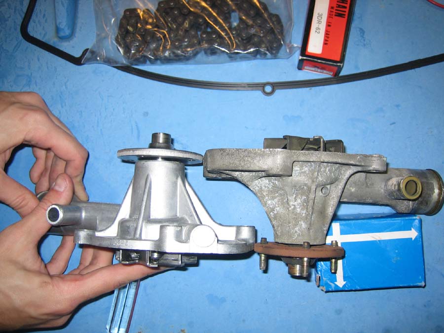

    Regarding the water pump
    I ordered a GMB (GW T45A) water pump for an EFI 2TG.
    This is what I ordered:
    It doesn't match what Toyodiy shows this for the OEM 3T-GTE water pump part number, but I'd say it is worth a try.

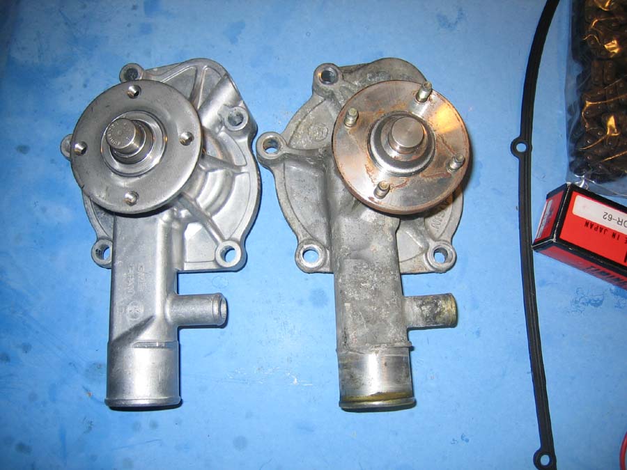

    Toyodiy:
    PUMP ASSY, WATER, W/O COUPLING, 16100‑88280 3TGTEU..TA63

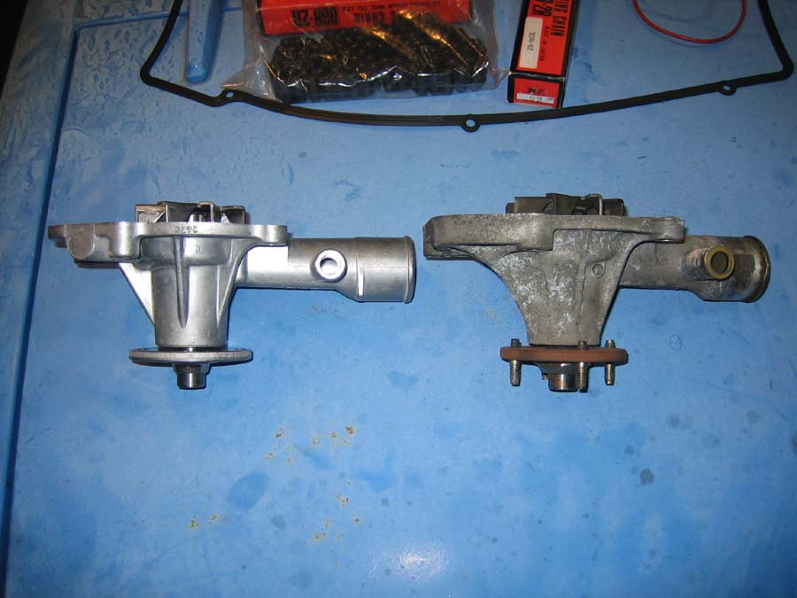

    Here it is beside the 3T-GTE one:
    And here is a measurement of the location of the flange:
    I haven't actually installed it on the car yet, but I don't foresee any issues.
