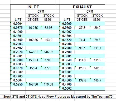

    As I get older and busier I find the Grey matter failing me more often. The shit I used to be able to quote with guaranteed accuracy I find myself checking more than half the time because I simply just don't play with the old T series all that often anymore.
    So while I still remember where to find it here is a little something from some flow bench testing I did somewhere around a decade ago. It should stir the discussion pool.
    Now before you all going looking to change your head, keep in mind port flow is only a small part of whats important in a head design and the the 3T-GTE head was the last development of the street issue T series for Toyota. It also has 2 spark plugs for a reason
