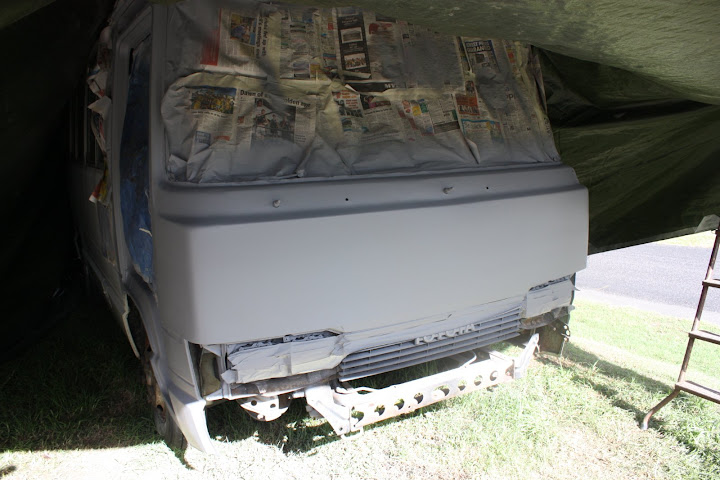

    Thanks all, tried today without the filter bit and worked a treat. This time around the finish over the repairs looks pretty good but wont know until I guide coat it and start sanding. I forgot to mask up the front wheel! Can I use some thinners on the tyre you reckon?
    I did get some runs in the hifill primer though. Is this just because I suck? I tried turning the fluid down but then it was sandy, but then added more fluid and got a nice finish but with some big runs.
    Also at one stage after refilling the gun with more primer it was spraying out like chunks of primer and made a mess of the finish. This seemed to go away though and then ran nice for the rest of the job. Would hate for that to happen with the colour.
    So far I have primed the front and around the door frame.
    Just to get this correct.. I now block back with a big sanding board and can I confirm what grades I start and finish with when blocking back the hifill? Do I have to prime again, or can I put colour straight over the blocked back hifill? Assuming I don't go back to metal/nikki anywhere.
    Some pics so far..
    1996 FZJ80 Landcruiser.
