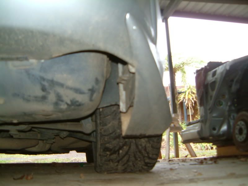

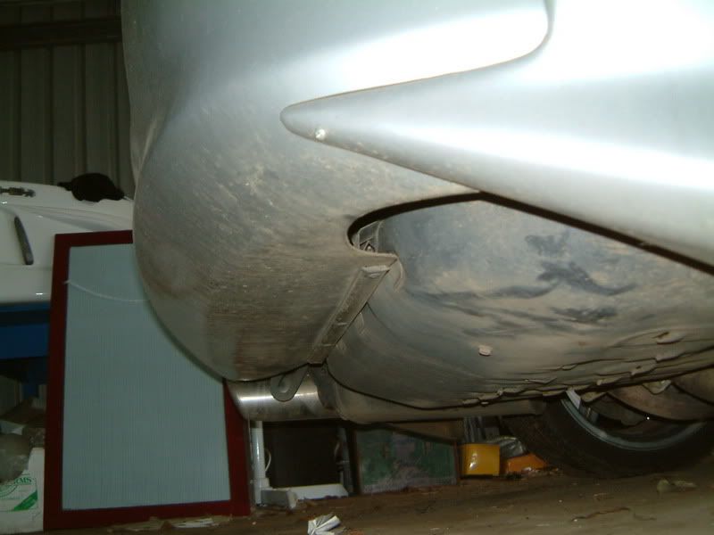

    There is really not enough room with the existing fuel tank. not to fit anything decent in there.
    Excuse the dirty car weathers been crap round here.
    4,152
    Default Re: JZA80 Supra exhaust
    Brilliant! Thanks for that. Looks like the only solution will be to join the twin exhausts right at the very end and bring them over to one side. Cheers for that!

    Actually that said, 2.5" isn't very big, perhaps something like this would be possible:
    I suppose I have to find out what the legalities are of how close an exhaust can be to a fuel tank.
    I don't know how viable that option would be either.
    4,281
    bee's dick of clearance in there... certainly not enough for an exhaust I'd feel safe with.
    4,152
    Guess it's back to plan B then. Run twin exhausts down the length of the car and join them at the very end.
    Penrith BC
    2,537
    bah...trust me, best left alone. youre going to bring the pipes together at some point in the system (aroun the gearbox outlet) and from there its a no brainer to the back of the car. fuel tank get a LONG way in the way. soarer doesnt even have a fuel tank in that position
