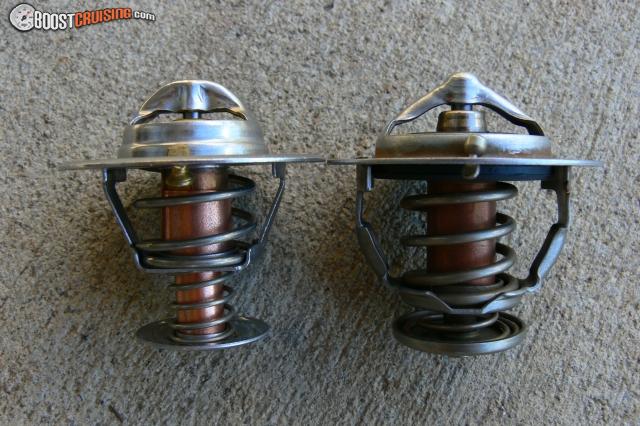

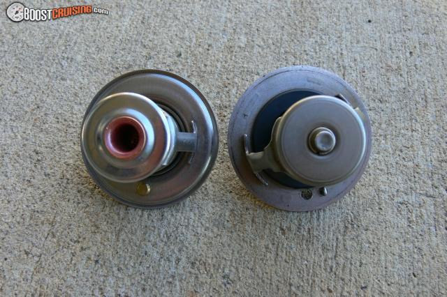

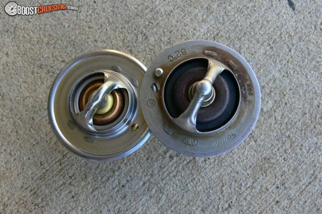

Here she is on the left compared to the old stocka on the right:
Yes the water opening diametre is a little smaller and the spring assembly looks different, but it all works perfect.
