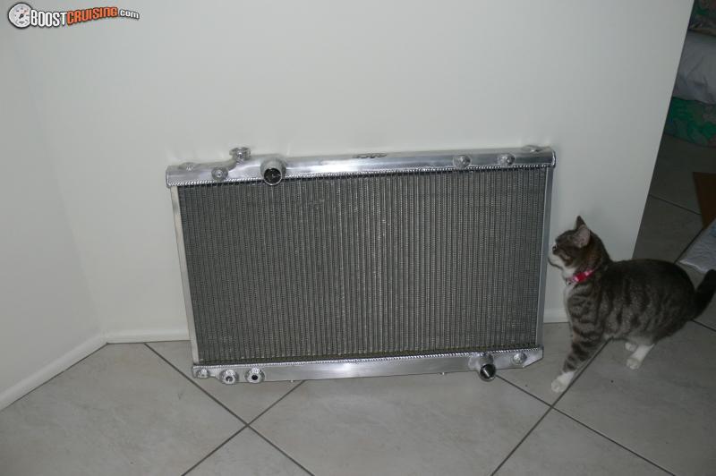

    Just installed a new alloy radiator and thermo fan into my aristo. The issue is that when i go for a drive, the temp gets up to 105degrees very quickly then will slowly rise from there(the temp sensor is in the top radiator hose). I have bypassed the temp switch for the fan and just got it running on accessories ATM to rule out the switch being at fault.
    Which way does the water flow through the radiator? I assumed it went from the radiator top tank into the motor, through the engine, down through the thermostat and back into the bottom of the radiator. Is that right? Or is it the other way around?
    I have felt the bottom tank and its stone cold but the top tank is excessively hot. My prime suspect is the thermostat, even though i just checked it and resinstalled it during my flush out with new coolant.
    Im gunna rip it out and inspect anyway. In the meantime, any ideas of what else it could be?

    Just pulled the thermostat out, tested it and its working perfectly.
    Its a brand new alloy racing radiator, so its not clogged or anything.

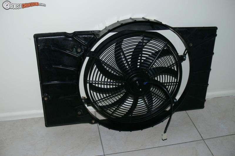

    It might be that the thermo fan is not strong enough to keep it cool. Its a 16" ebay job, meant to flow 2750 cfm. Heres a pic of the new fan in the shroud and the radiator.
    Maybe i should convert back to the twin thermo's i got from a ford corsair...

    you want the fans to be sitting on or close as the radiator
    where it is there with that fan wont do shit
    is there a gap between radiator and fan

    The thermo is sitting right next to the radiator core, the pic doesnt do it justice. Keep in mind that the bottom of the radiator is VERY COLD, so it must be cooling pretty well. The top tank gets around 105degrees and the bottom is around 30-40 degrees.

    you do need to block off the gap between fan and shroud, as the shroud is doing nothing.
