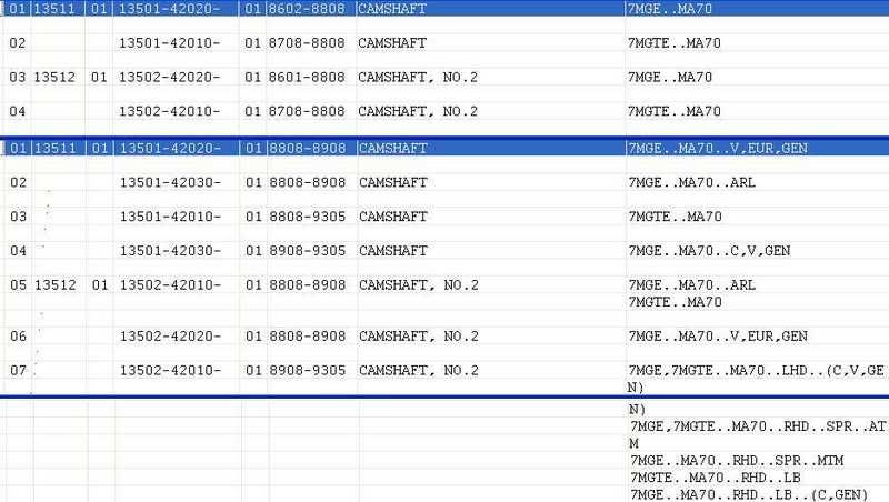

    According to the EPC the exhaust cams are the same for both GTE and GE.
    GTE Inlet cams have more lift. But I'm not sure about the inlet cam duration.
    oregon
    1,417
    Default Re: identifying marks between 7MGE and 7MGTE cams???
    Quote Originally Posted by amichie
    Be careful.... the earlier 7M(87-89) have both cams as different. It is only beginning in 1990 that the two share the same exh cam....
