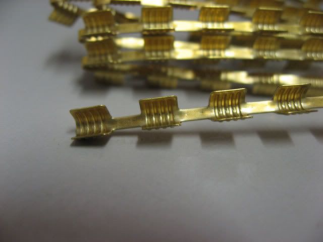

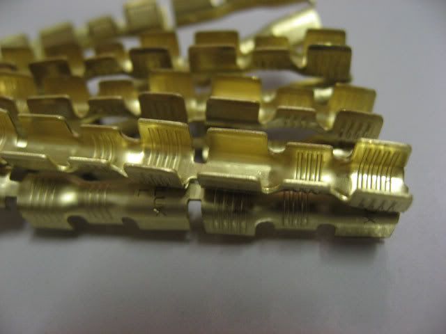

    went down to Jaydee's, got 2 different sizes. Now I need to find a good rolling crimper to test'em.
    Some Nasa standards I found interesting
    http://workmanship.nasa.gov/lib/insp...20Splices.html

    They costed $4 a packet (25)
    Anyone used the supercrimp tool? looks promising.
    http://www.electusdistribution.com.a...WORD&SUBCATID=

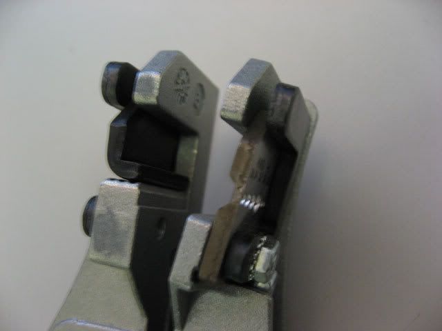

    3,164
    Default Re: Cable "connectors"
    the proskit crimper is awesome... thats what i use.
    You gotta get the "non-insulated terminals" die to suit though.
    i might have to look at those in-line crimp thingies soon too.... maybe i can add those to the Jaycar range as well
    Hey Witzl does that crimper with the die set "roll". It looks like its compress type?

    Quote Originally Posted by thanhngo
    It uses the die to roll it... all rolling crimpers compress.

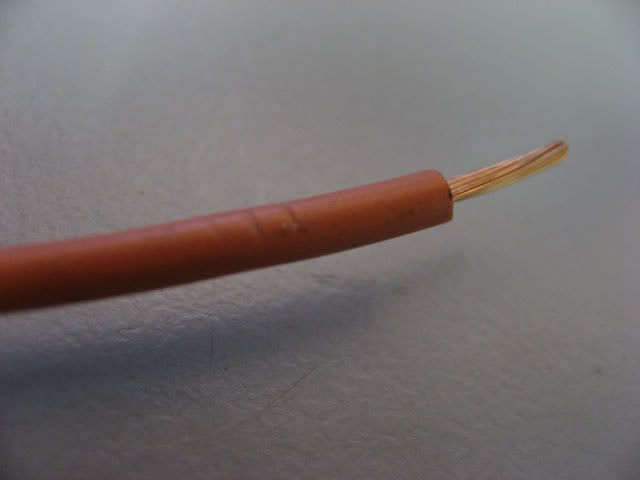

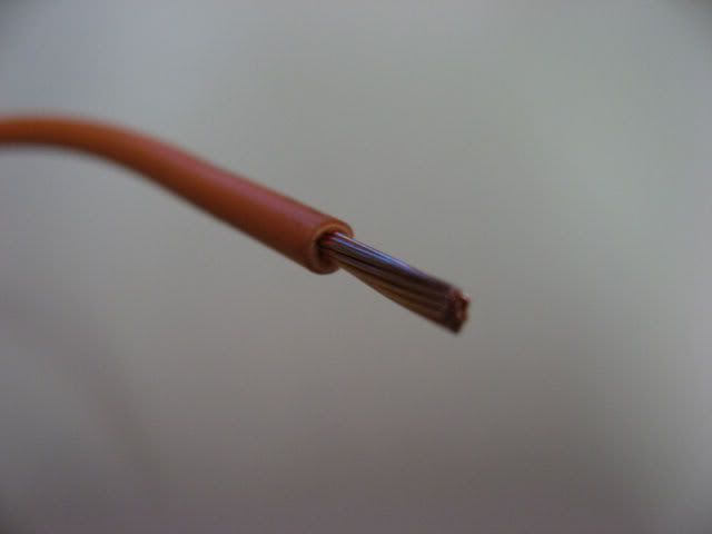

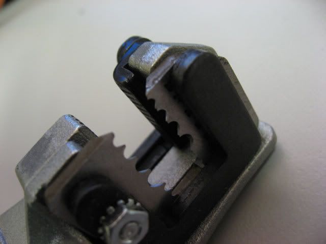

    My new wire stripper: Ideal industries wire stripper
    Has blades to cut the insulation, a spring loaded clamp to hold down the wire and it does the splits to pull the insulation off 10-22 awg with replaceable/upgradable blades
    some teeth marks on the insulation from the clamp...need to find if i can adjust this.
  15. #75
    6,684
    I wouldnt worry too much about those teeth marks, they arent slicing the insulation, just indenting it, so shouldnt be a worry at all.
