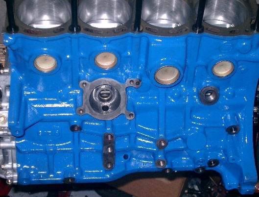

    Quote Originally Posted by twentyEight
    Exhaust side - Block B
    How am I going to feed the oil to the turbo???
    I'm almost 100% sure that the big bolt in the larger white circle in that above diagram is the feed for the oil return banjo-bolt. I know because I spent friggin ages chasing one down for my turbo conversion in the RAV, and that was a block out of an ST185.
    This was my block just after it was painted.. I was hunting one of these bolts for it, and if I remember correctly it was something like a 26mm thread or something stupid, but I just know that it was hard to get a hold of because no one knew what it was! but that's almost certainly where the oil return line goes.
    Hope that helps... a bit..
