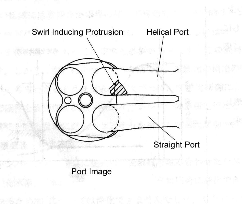

    Update:
    While doing some checking around I found out that some Japanese 7A have the split ports and swirl stuff.
    If you are picking one up, make sure you are getting the type you want (with or without the swirl (junk)).
    I will put up some scans later,

    Quote Originally Posted by 3sgte
    Update:
    If you do a search on this forum, someone's already posted up some photos of that head.

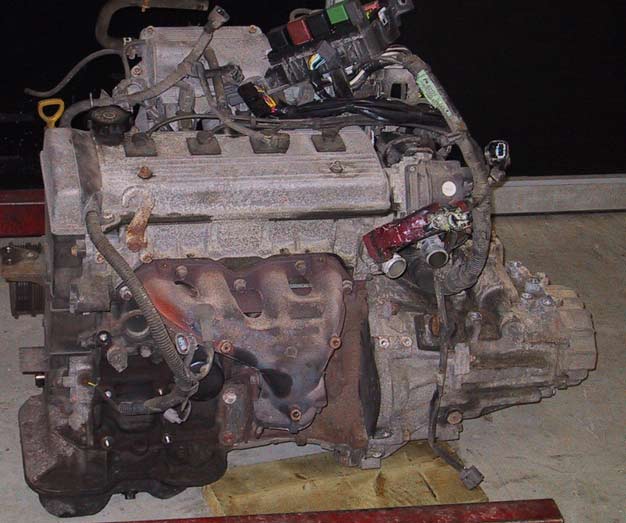

    The 7A head I am familiar with is the single port head, the same as the 4A of the same vintage.
    It caught me off guard to see a 7A with those little add-ons.
    FWIW, here is the old 7A I pulled out of my Corolla to fit a 3SGE.
    228,000 kms on it. I wound up giving it away for free.
    1995 Canadian 7A-FE (single intake port type, no EGR, fitted with stock crank sensor)
    Here is a Caldina 7AFE:
