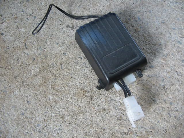

    As I said before the car wouldn't start. This was obviously due to me removing the alarm module, which is powered by the ignition and creates an earth loop throught that plug with the two black wires:
    I plugged that module back in and the Lux started fine. In fact it really sprang into life unlike I have noticed previously. The battery was really strong - no two or three turns of the key. I also noticed idle was up at 2K RPM, unlike before when it idled so rough I had to use the pedal to keep it going for a minute or so. It eventually settled around 1K and I turned it off.
