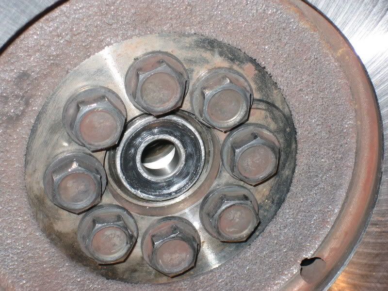

    Hi guys I'm having a silly issue with fitting the spigot bearing into my 86kw flywheel. It wont fit in!
    I have the bearing here, part no: 6001-2RSH. its an SKF. Is this the correct bearing?i was pretty positive it was, but it seems to not want to fit.
    To make the installation (or so i thought)i tried a couple of little tricks: I put the bearing in the freezer for the night and i also quickly heated up the flywheel with the heatgun, so it would hopefully all slide in together nicely.
    Note:I used a socket the size of the outer race and tapped it in.
    So anyone know what's up?
    Have i got the wrong bearing, or am i doing something wrong?

    NTN part number is: NTN6001LLBC4/2A
    Which is 28mm OD 12mm ID and 8mm thick.
    RS shows the 6001-2RSH as being those dimensions but with a double rubber seal.
    So you have the right one, or an equivalent.
    From your photo it looks like you have installed it off center though, and so its fouling as the diagonal diameter is larger than it is when square.

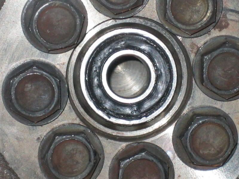

    you have to press bearings in square, and you need to heat the WHOLE flywheel up for it to expand. Put the flywheel in the oven and heat it to about 120 degrees.
    actually, don't do that, take it out again, polish the hole up a little, smear a light film of oil on it, and try again. it 's not supposed to be so tight in there.

    Ok, That's annoying. I've already torqued/loctited the flywheel bolts up.
    I'm pretty sure i've stuffed the bearing up that is half in there atm. So i will get that.
    but surely there's another way to fitting it..

    also the bearing will last ten times longer if you pack it with some grease. bearings are packaged with a small amount of 'brinelling' grease only, which is only meant to prevent the bearings from rattling and vibrating in transport.

    This is a sealed bearing though. well one of the casings on the side has come off on this bearing.Can i pack it will grease and refit it? and leave the casing off the side?or put it back on?

    they flick out easy with something like a small screwdriver, or a scriber. pack it with grease (whatever, i use APXT blue grease, or you could use EPL2) then just push them back in with your fingers. easy.

    Can i leave the casing off Joe? because one of them is a little warped and distorted.I think it might fall off when its all moving..

    it's pretty easy to straighten them. if you still have doubts, put that side of the bearing inwards, that way if it comes off it won't end up in the clutch, and the grease can't get out into the clutch either. you can leave it off, but if you do i'd pack the hole in the crank with a little bit of grease too.

    Quote Originally Posted by joecoolmk2
    Doesnt the spigot bearing press into the crankshaft not the flywheel?
    it does look like you have put it in off centre.
    try and remove it and see if there are any score marks in the hole

    Quote Originally Posted by ae95
    yeah it does. I knew what he meant
    Yeah it went in on an angle. I got it out and there is a little score. I will clean up the hole and try the bearing again with a bit of grease and some more heat.

    haha yeah, my bad, but you get the idea. on second thought, if you're gonna do that, which you really shouldn't need to, you will probly need to remove the main rear seal, or you'll burn it with the oxy torch.

    Give the inside of the crank a quick sand with some wet and dry, 300 - 600 grit to remove any rust build up that may have occurred, it could be making it hard to get it in
