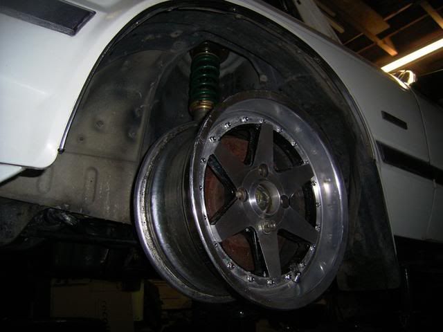

    my main concern now tho. is the angle of the lca its almost horizontal so obvously i think its a bit of a problem atm. and is the main factor of this working or not.

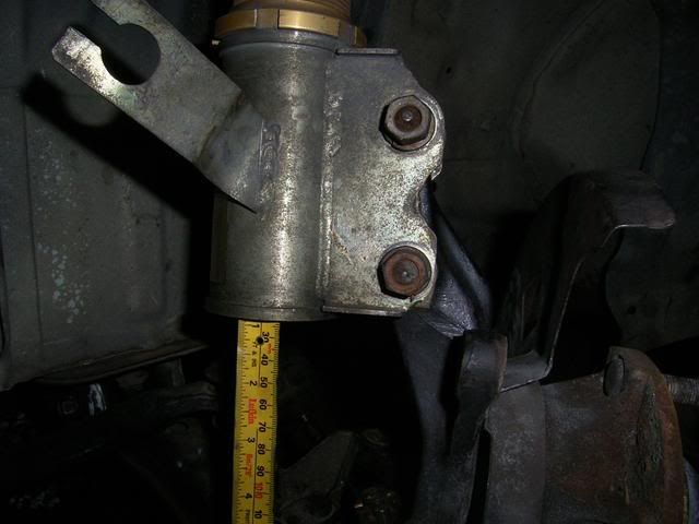

    ill have to take some good pics of the set up togeather but ive got my two way hight adj. kai office coilovers and ive screwed the strut about 20mm up from the bottom of the base of the coilover and the spring perch screwed about 50mm from the top... which makes about 550mm (hub to top of camber plate)
    has anyone on here droped there soarer 100mm odd?
    heres a doggy pic... on up side is i dont think postive camber is a problem with this set up... i measuered the hub lengths between the two and its 10mm shorter on the s13 hub.
    notice lca...
    no backyard Domestic Engineer japlish's Avatar
    470
    Default Re: S13 suspension (front and rear) into MZ11/Ma61
    i think my lca's are almost horizontal as well and it seems ok.
    the outer rack-ends even angle upwards.....

    Low Down Style Domestic Engineer Johnzoku's Avatar
    queensland
    713
    hate waiting on parts! heres some better pics, it looks the good to me jsut have to redrill the strut top and im done.
    470
    yeah that looks like it'll be ok.....just
