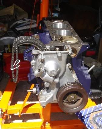

    From memory, you don't have to remove the large curved guide, and it helps in holding the chain up. What I do is mark links on the chain, and respective teeth on the cam gear, then put a cable tie or a bit of wire through a couple of links in the chain. You can get a bit of tension on the chain, and carefully fold it so it sits wedged between the block and the curved chain damper.
    The above is a photo I took just before putting my head on. You get what I mean? I've never had a problem with the chain falling off the lower cog, and I *think* there is even a dowel down there which helps hold it up. It will fall off the aux. drive though, so make sure you reset timing after the job is done!
    Hope that helps!
