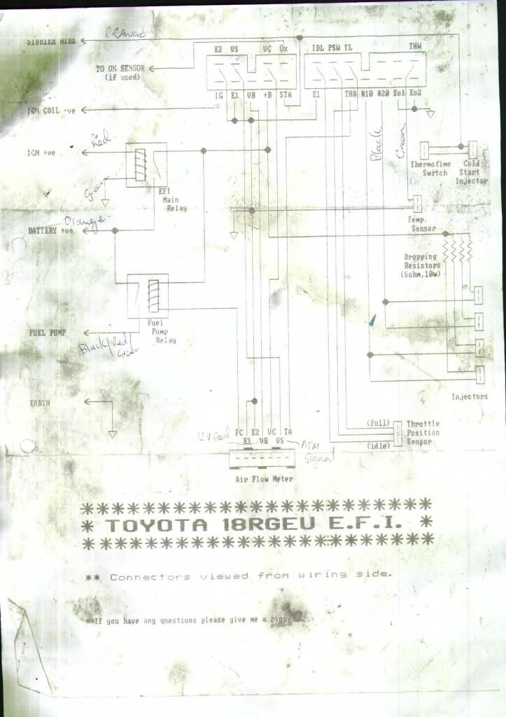

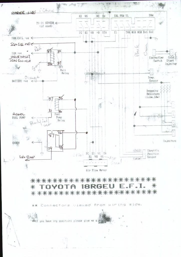

    Im finally back to working on the tractor.
    In short....18rgeu with std ecu.
    My previous problem was, starting but died at idle after 5-20 sec's
    Fuel pumps seemed to have a problem getting signal.
    Well im now back to problem solving the harness.
    I have re-wired the relays as shown on diagram and added the extra relay for lift pump. see Diag 1
    I've also added a VE+ coil wire, which my previous wiring diagram did not have. See diag 2.
    Now that i've fixed the signal problem with pumps, so they now come on from AFM signal.
    I have now got issues with no spark or injector (Firing) signal. i get power to the coil and injectors but no pulsing.
    I feel its a coil problem due to primary Ohms being zero and secondaries being 15.6Ohms.
    Also the ballast resister, has no resistance showing.
    In short i will change to a new coil and resister, BUT...
    Looking at my new diag 1, when adding the VE+ wiring, could this cause the burnout of the coil/ballast?????
    The previous diag 2, as we said shows no VE+ wire anywhere.
    So previous to coil problem, injectors were firing, as per the wiring shown.
    any hints or help would be great. if i dont solve this i will probably leave it sitting for another year.

    has anyone had a chance at looking at the diagrams?
    theres a few different diagrams out there, but this is what my harness was made from.
  14. #5579
    Sydney N.S.W
    852
    can someone check in diag 1. if i have the main relay wires mixed up.
    that is, relay 30 and 87 should be around the other way.
    30 to battery and 87 to 12v supply from ecu..or its ok the way it is?

  15. #5580
    504
    Quote Originally Posted by Omegaman View Post
    yes its a factory igniter...
    i will use a prob light tonight.
    i've got power to coil, from + side to - side of coil.
    so, if i put prob light on battery + and the other to - of coil it should pulse when cranking.
    if not, that confirmation of a bad coil..
    That's correct, if you go from B+ to the -ve side of the coil it should pulse while cranking. You can even just go across the coil. If it doesn't pulse it would likely mean a bad igniter as the igniter isn't grounding / firing the coil thus giving you your pulse. Those igniters are crapping out a lot these days.
    please don't think, just because it say's I'm a "Domestic Engineer" in profil, that i know what i'm doing....
    As far as the wiring diagram goes, it looks pretty much the same as I used to wire up mine: http://www.garagedori.com/tech/efi/1...ng_diagram.gif
    Regarding the pins 87/30 being backwards, it won't matter in reality. It's just a contact that closes.
