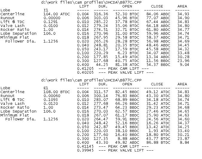

    These are the specs on my reground cams... Will these do the job?
    Also see attached full head rebuild receipt (only 25000kms ago, wanted to just chuck this head on as is if I could...) which includes heavier than stock valve springs and oversized exhaust valves... Would have been handy if they included the actual specs on how much heavier and how much oversized on the recipt as I can remember

    Engine was sold long ago mate...early 90's. the buyer was playing with cam timing, god knows why, and forgot to put the lock pins in.....spun cams and bent every TRD valve
    Your cams are pretty damn big duration wise and 10mm lift will be fine.
    No detail on head mod work if any?, but the rebuild can't have hurt.
    Build and enjoy
