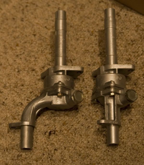

  11. #4766
    614
    The ECU from that 18rgeu in Moonta looks like a Delco item that I have on one of my 18RGEU sets. Uses MAP sensor.
    lilcrash.
    The oilpump pickups are different.
    Left Corona sump, Right Celica sump.
    I am lead to believe that the corona pump will fit in the celica sump and when the pickup is rotated you end up with a more centred pick up.
    This is done to reduce the risk of the infamous 18rg oil delivery troubles on hard cornering.

  13. #4768
    711
    I can't remember what my oil pump looks like now . We bought it with mid sump and fitted a front sump. But my dad may have changed pumps or pickups while I was busy. I guess it doesn't matter if both fit in a mid sump though.
