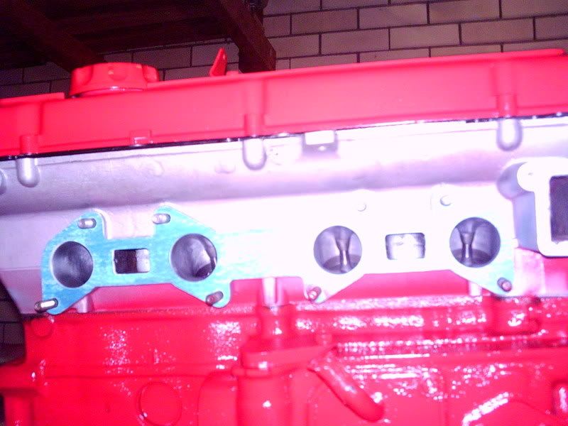

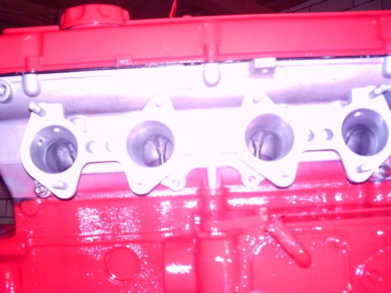

    Will keep you posted of the results but my 2.2L is nearly back together after the last guy who assemble it fuked everything but thats another story. Here are some pics of the ports on my engine
