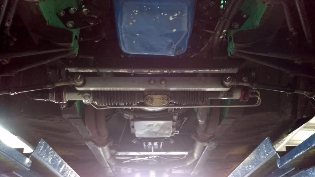

    sorry to dig up an old thread, but, i saw this today and remembered many people working through the trials and tribulations of R&P for their TA22's
    this was done in an XL/M Ford Falcon wagon.
    It uses a Camira power steering rack, and as you can see, the alloy bar held by the two bolts in the middle is what drives the steering, it is sufficiently long enough to pick up the Falcon inner tie rods.
    Its another piece in a never ending puzzle, but may give someone an idea.
    Hope this helps,

    Default Re: TA22 + rack and pinion
    That's an interesting idea Grega, you could create adjustable bumpsteer curves with a bar like that with 3-4 holes in each end for tie-rod length adjustment... So much simpler than shortening an *E7* rack to optimise bumpsteer characteristics
    Any picture/idea of how the Camira rack input spline can be mounted to a TA22 steering column?
