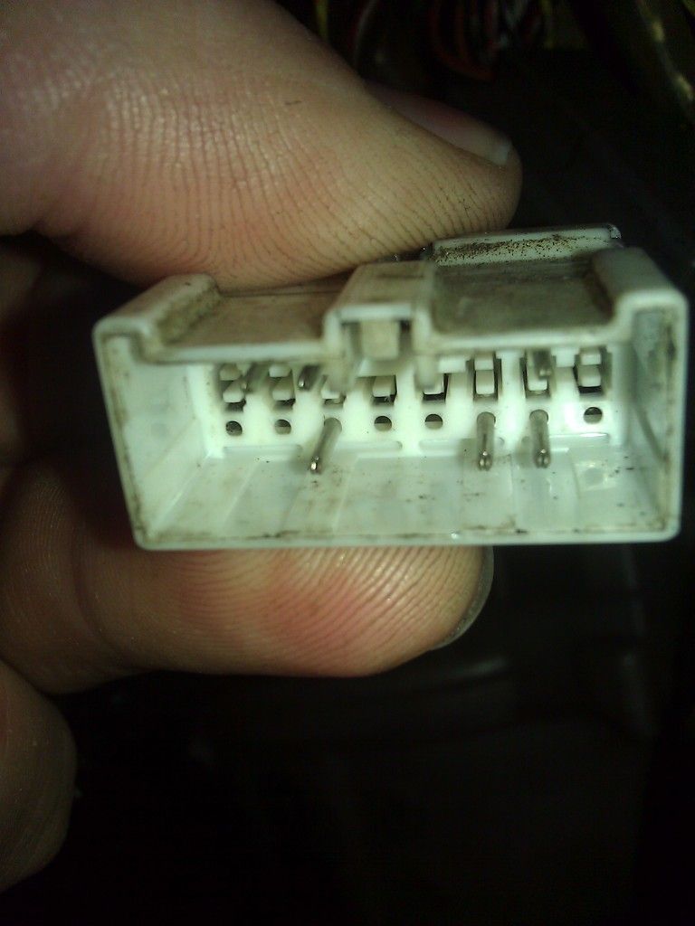

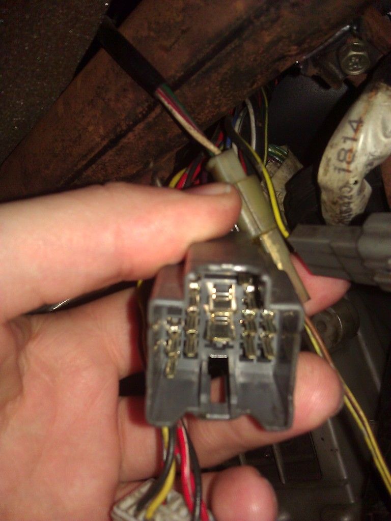

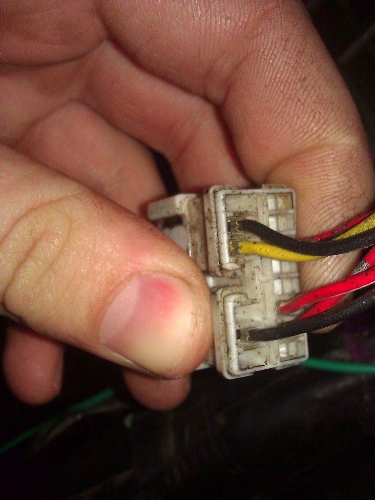

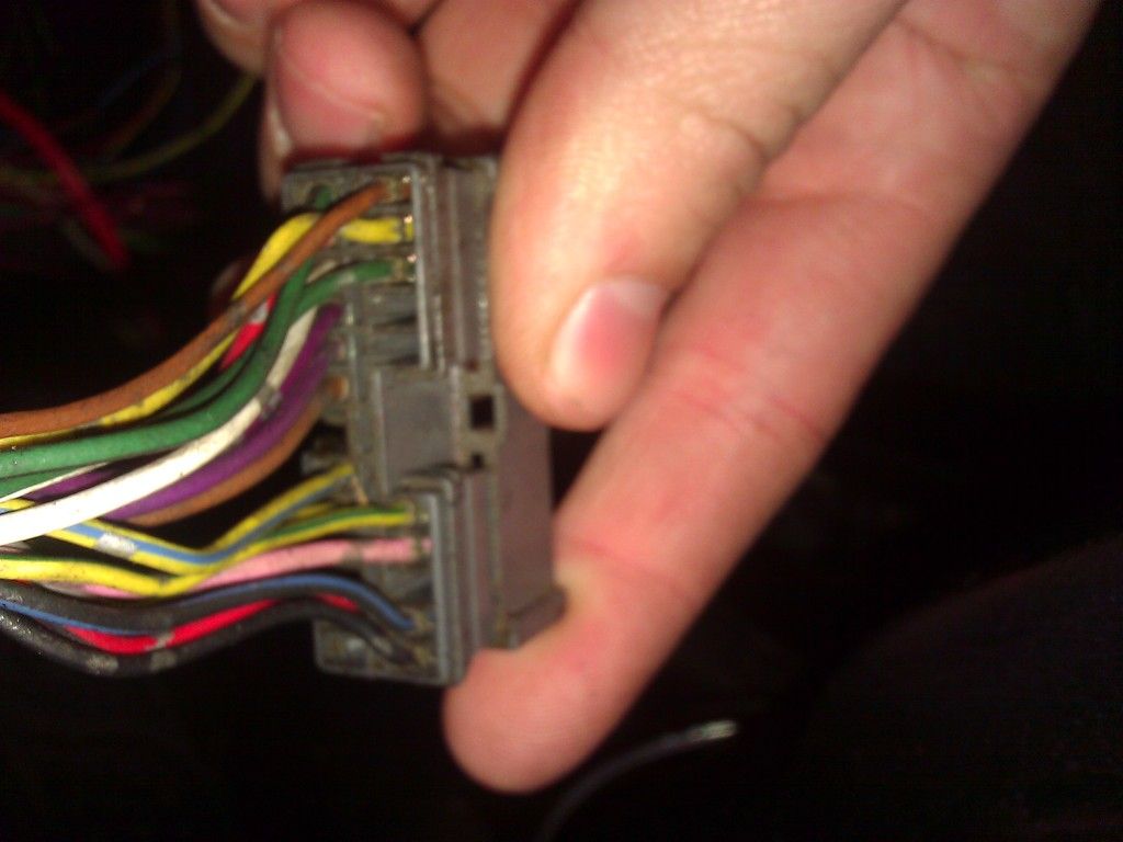

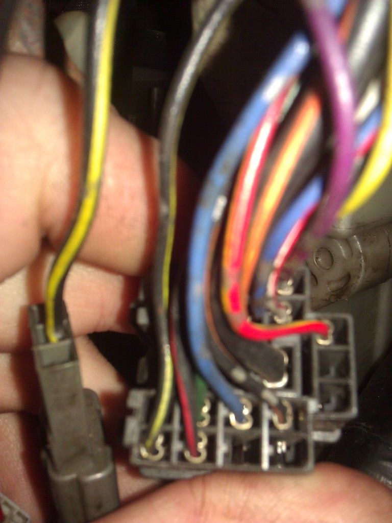

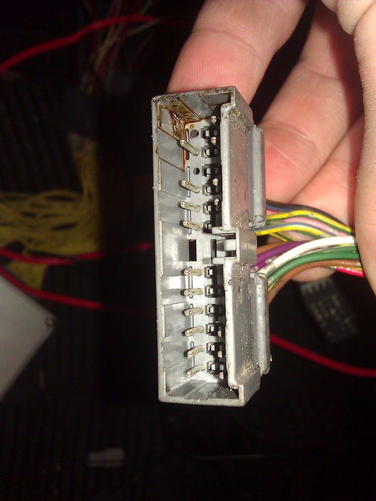

    From what ive looked at it seems i have 2 of the B2 plugs, one early and one late. Its racking my brain. Can anyone help please. Pics of my bodyplugs below.
    What looks to be early model B1 plug
    And the two plugs that seem to be early and late model B2 plugs.

    1st picture middle row big thick wires 1 (probably black/white stripe) starter signal from ignition barrel
    other 1 black/organge ignition power
    the aristo loom should have similar wires for the starter and ignition power for injectors/coils/ignitor
    join together and the car in theory should start... (but use the above technique to clarify what goes to what...)
    the rectangle grey plug has things like reverse lights and feeds to the dash for gauges etc...
    tacho is black/silver band
    reverse lights are red with something
    water temp gauge is a yellow with blue or green band i believe

    to get it to fire it should be pretty straight forward...
    the 2 thick wires in the plug in the 1st pic are the key...
    corresponding pins should be on the orange plug in the aristo loom from memory

    Just thought id post up. Could never find an exact pinout for the bottom grey plug, but by using the wire colours I have the car running now and most of the gauges working. Cheers for your help guys.
