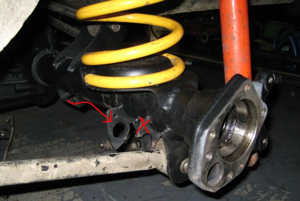

    Quote Originally Posted by jabbatron View Post
    This is what i did with the handbrake cable mounts, hopefully it clears the lower control arms.
    Jabba,
    unfortunately, that handbrake cable mount between the lower trailing arm mount will hit on the trailing arm - this is the problem I had when fitting mine.
    You will need to cut that off.
    Note my pic here - http://i1176.photobucket.com/albums/...g?t=1306486391
    You can see the tab marked with X has been cut off, and you can see why with the diff fitted to the car..... the lower trailing arm wont fit otherwise.
    Besides - that one isnt really required for the handbrake cables.... all it does is locate a plastic tube of sorts, most likely just to protect the handbrake cable from dirt and shit.
